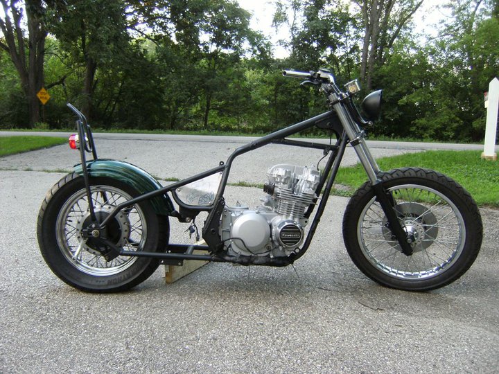

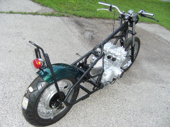

I use a peanut tank on my bobber, this should give you an idea of a way it can be done. You are basically going to need to cut the frame and start with your rear extension, then work out the angle for the backbone then figure additional bracing to your liking. I dont think the stock angle will look right for any tanks other than the stock type ones. I completed this bike in Feb 2012 and have been riding it daily every season since.
You will have to check specs for fitment but I would take a look at 750s in the same year range as your 650, as well as some 650CSRs for a 19" front spoke wheel

Thanks for the pics! Definitely gives me a good idea if i decide to go this route. Your bike looks great by the way!
