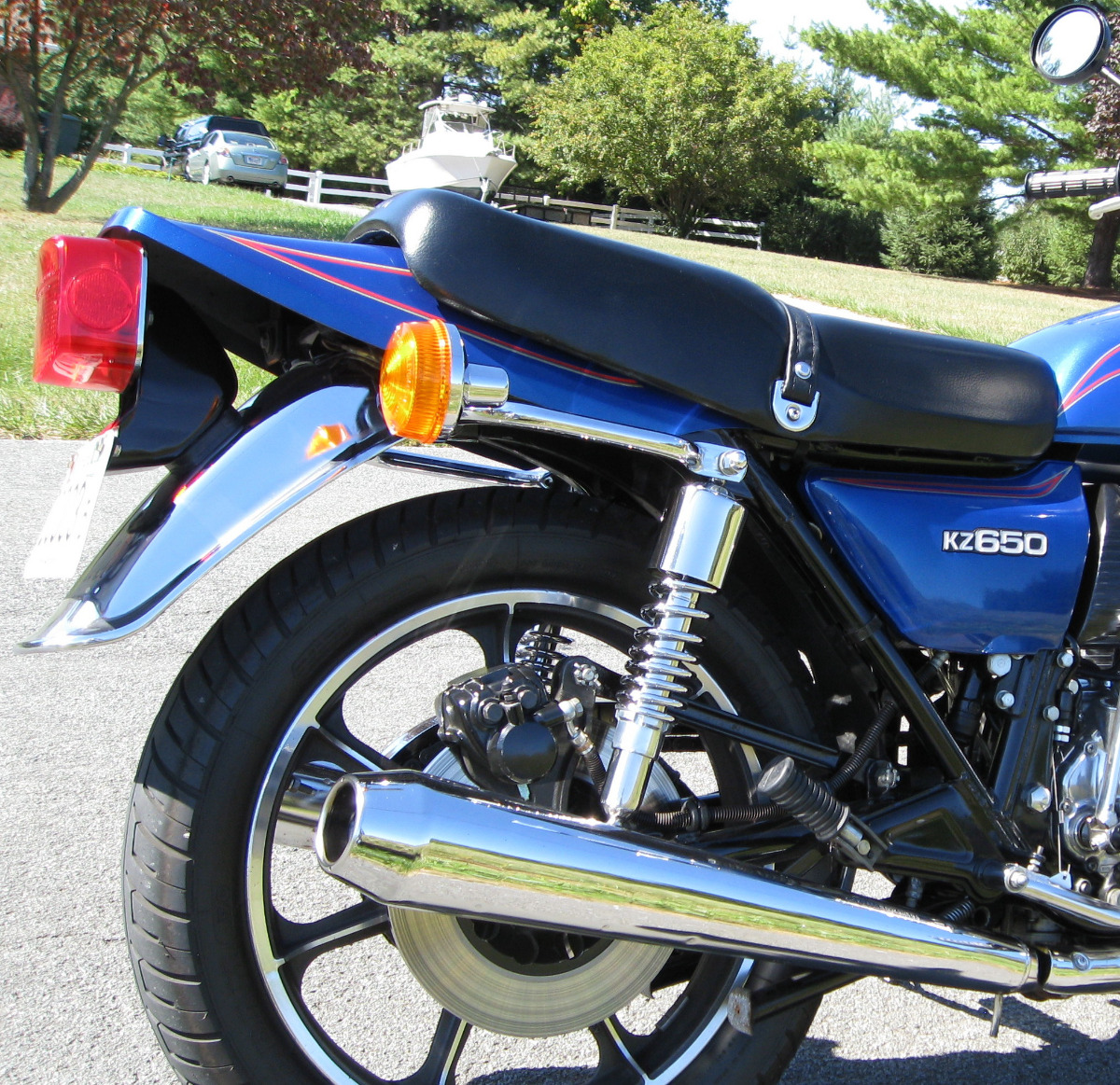

I love my Hagon shocks. I've had them for 7 years (about 12,000 miles) and they still look and work like they are new (picture below). Mine are #4 in the last picture near bottom of link.
davequinnmotorcycles.com/cgi-bin/webc.cg...GON_TWIN_SHOCKS.html
If you contact Dave Quinn (see link) he will answer any questions and set the shocks up for your specific weight, riding style, etc. Ed
