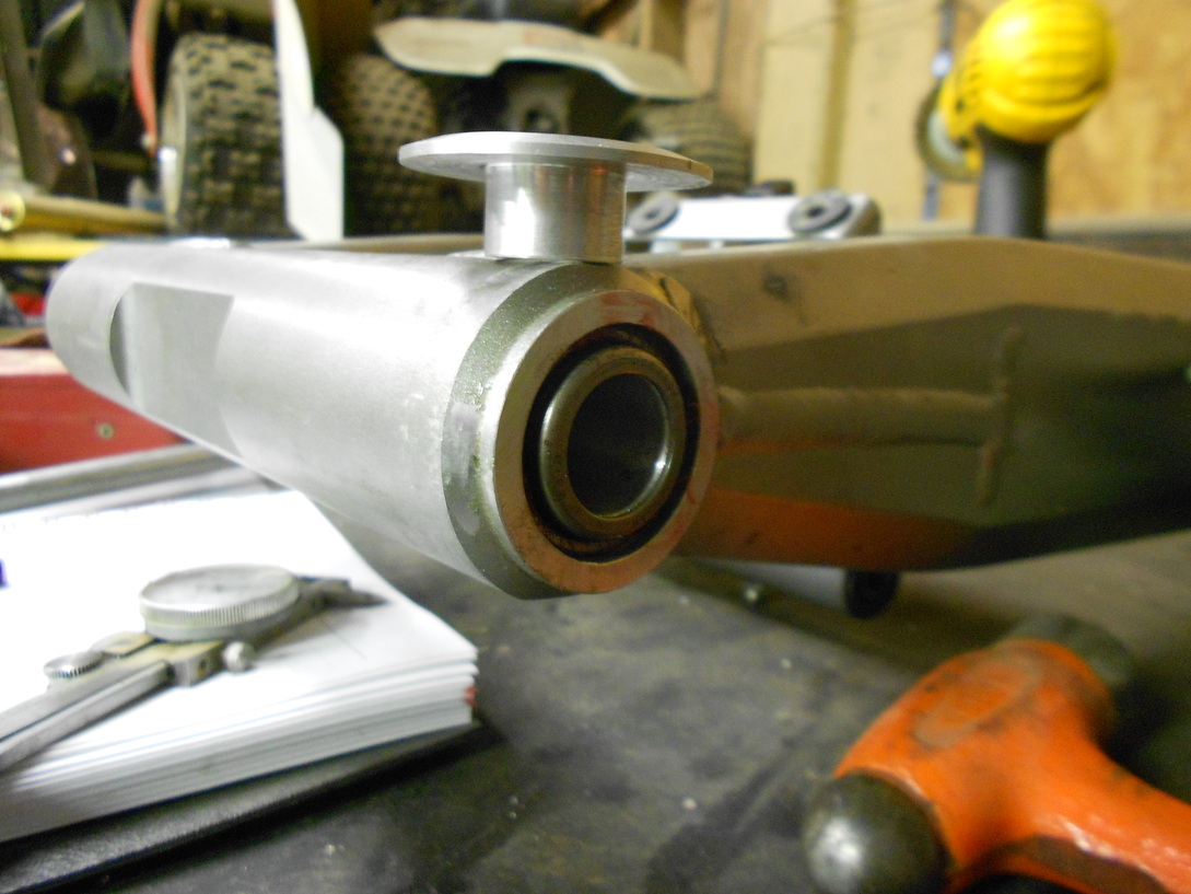

as turboking said.
i have custom machined tophat bushings to take up the difference on the swaps i have done.
these are on a zx6r swingarm to kz.
