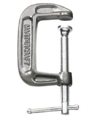

Do you mean push the piston in the brake caliper back a bit ?
If so then I use one of these or a similar type of clamp. It should not require much pressure.

Open the bleeder valve first then use a flat blade screwdriver to pry it open ;)
Also put a short length of clear tube on the bleeder valve so you can keep from making a mess and keep air out of the caliper.

I was hoping I don't have to remove any liquid. I don't have any of those clamps. Any other suggestions? :P

If you don't have a C-clamp its time for a new tool, They're like $5. Many, many, uses. I have over 30 of various sizes/shapes. Or you could rent a caliper piston press thing from any auto place, which would likely be as much as a buying a c-clamp.

You are right. Im going to buy one.

Leave the old brake pad against the piston when you commpress the piston and put an old rag on outside of caliper to protect it from c clamp.

too late. a neighbor had one and it got in smooth without any force. installed in a minute :) thank you guys
