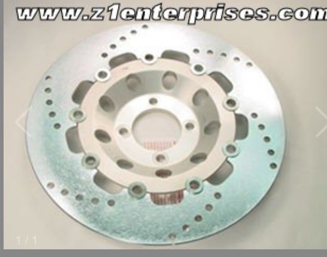

I apologize, I should have been more specific - Since i went to spoke wheels this is a disc for a KZ750, despite the bike being a 550. The OEM part is 41080-005.
This rotor has a center bracket that the bolts go through, but the rotor is attached to the bracket with what looks to be rivets. I am looking an an EBC MD4052LS replacement, and from images it appears this bracket is not included, although they do say 'bolt on'.

25 Jul 2014 13:46ChicagoLTD wrote: I apologize, I should have been more specific - Since i went to spoke wheels this is a disc for a KZ750, despite the bike being a 550. The OEM part is 41080-005.
That EBC plate won't work. The type rotor in your picture must be bought as a complete unit. You cannot just attach a flat rotor to the hub part. Ed

I believe the "prolite" series uses a aluminum carrier. If it doesn't have a carrier it would not be in the "prolite" series as the carrier is what separates it from their other products. They dont photograph each rotor for every model. its one photo for all rotors. They use a better stainless alloy with a better friction coefficient than the stock rotors. combine that with some good pads and stainless lines and you will have very good stopping power.

25 Jul 2014 14:02DoctoRot wrote: I believe the "prolite" series uses a aluminum carrier. They dont photograph each rotor for every model. its one photo for every rotor. They use a better stainless alloy with a better friction coefficient than the stock rotors. combine that with some good pads and stainless lines and you will have very good stopping power.
Ok, this was my hope. Z1 has a picture for another model of the same EBC Pro Lite rotor and it looks to me like it had that center bracket/carrier. I just didn't want to drop the cash if I was not certain.
