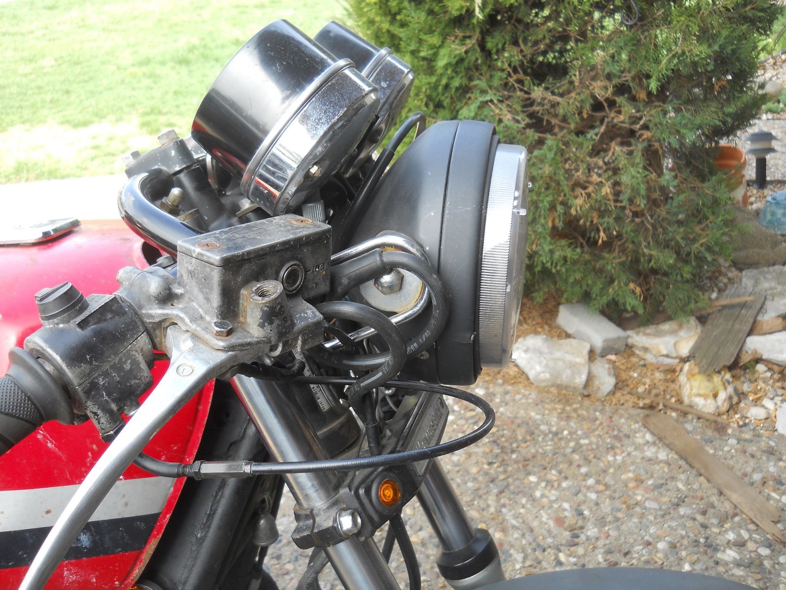

Re: Brake line for handlebar swap
03 Apr 2014 15:21
Factory brake line and clutch cable will work with creative routing.
Example - superbike bars
www.kzrider.com/forum/5-chassis/593332-b...andlebar-swap/reply#
Café bars
That can give you a chance to test the new bars before buying new cables if you want better routing.

Rainman, is that a "C" "LTD" master cylinder?
