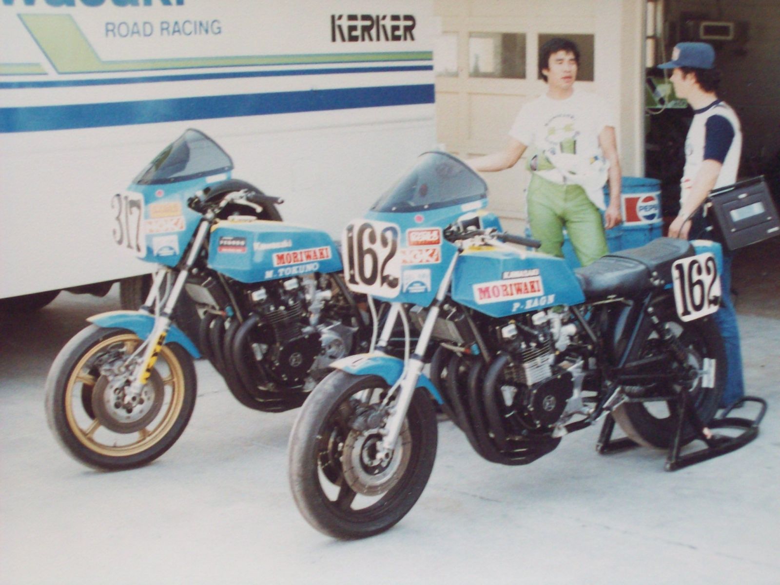

Moriwaki Superbike project!!! Can't wait to see it!!!
This is from I think Daytona 1979.
Sorry about quality of picture, I took a photo of one of my old pictures from back in 1979
