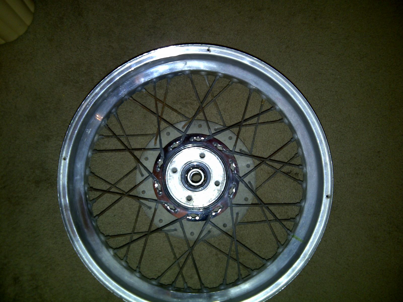

I am working on my 81 kz 1000 ltd.I like the spoke wheels.Several of the spokes have rust on them.I dont know which is the best most economical way to go.I doubt i could buy spokes and relace them.Some place like buchanans would cost me a ziillion dollars.I dont see hoaw anyone could blast the rust off, get into all the spaces.Input appreciated.

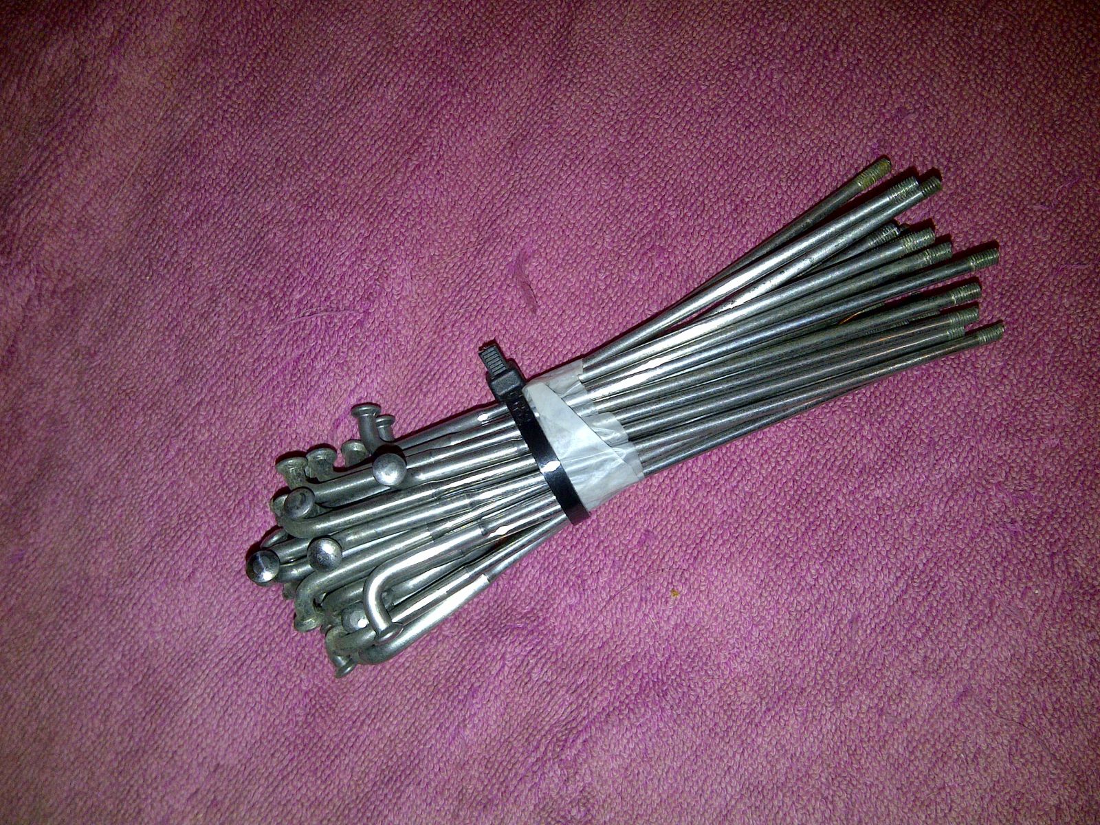

I have been working on a rear wheel with spokes and What I did was take them all out and lay them on a bucket lid of vaporrust and that worked great. But I had problems with the threads so ended up ordering a set. I do have a before picture of the spokes

Brian, here on this site, said i was stuck with the spoke wheels unless i changed front ends, forks, brakes, and all.I have another frame with forks, rotors and mag wheels I could swap over i suppose.I think it might be a 78,79.I thought i just swap the spoke wheels for the mag wheels.He said no.
Proud owner of 1982 650csr again soon. keeping it this time

29 Jan 2014 15:24Your rusty picture looks like my rusty picture.I would rather just switch to mags.I doubt i could ever get a wheel laced.
