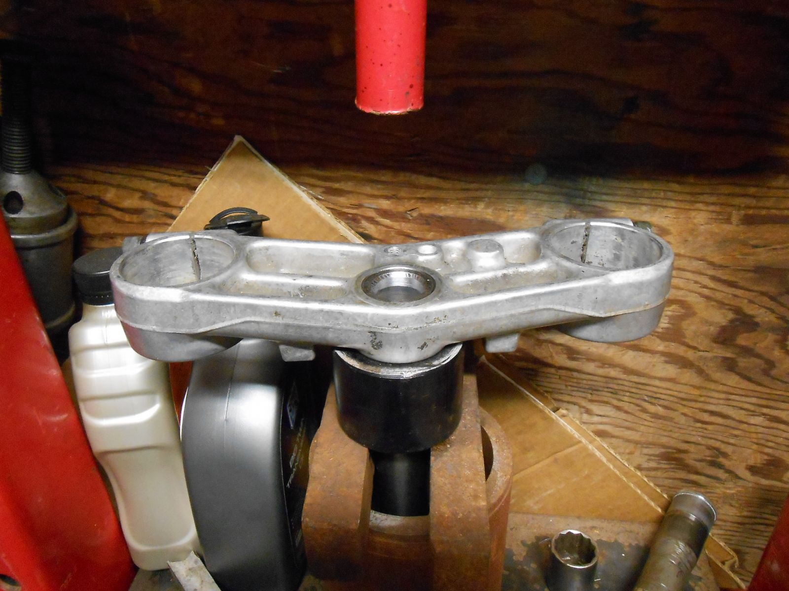

On a KZ650, which way is the stem pressed out after the weld is ground off?

Re: KZ650 Stem Removal
25 Nov 2013 09:43
it will press from the bottom out the top.

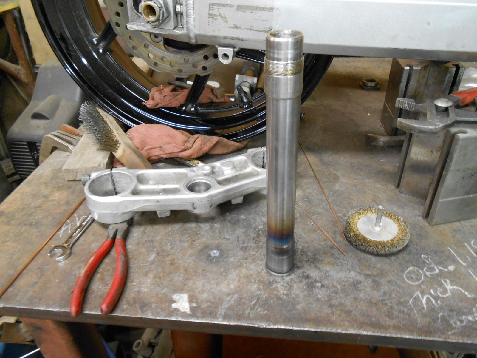

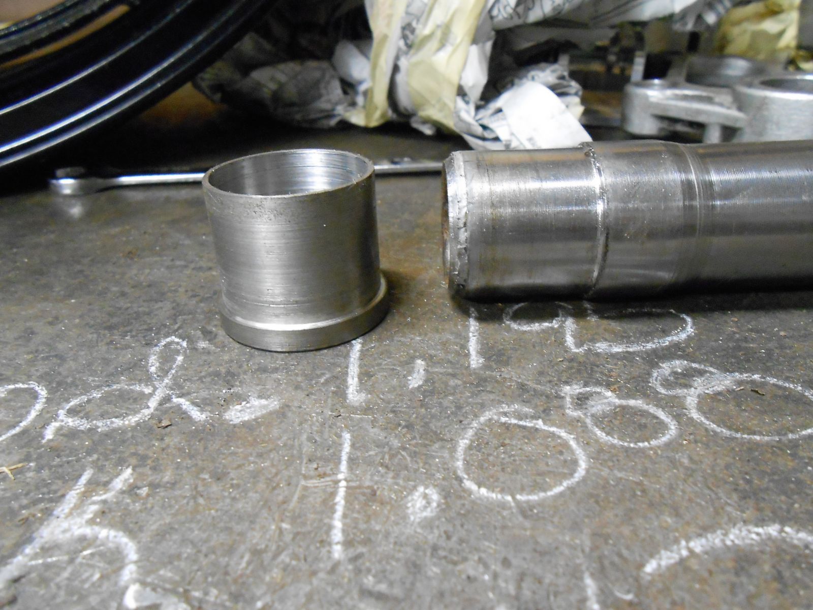

26 Nov 2013 06:30Is that a flange that gets welded on the bottom of the stem to get pressed through an aluminum triple?

- Posts: 7442
26 Nov 2013 11:42
