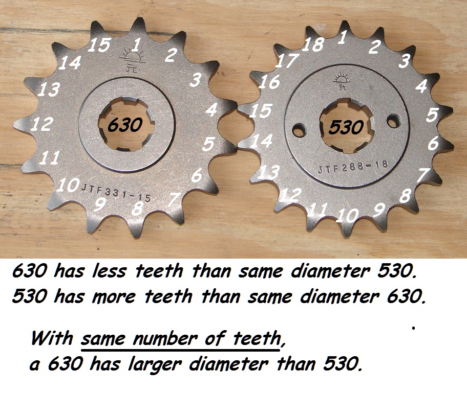

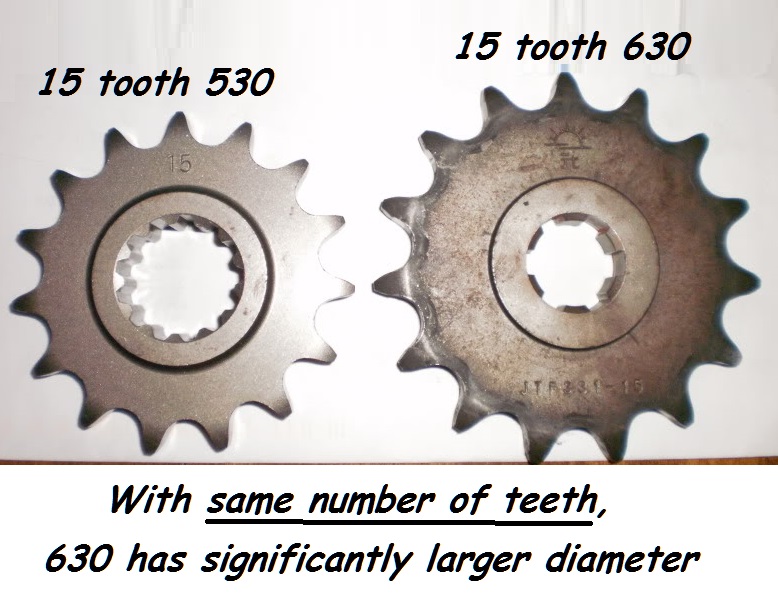

The 16 tooth 630 sprocket will be physically larger -- significantly greater diameter -- than the stock 16 tooth 530 sprocket (see illustrations below).
(Might be too big to fit into the space afforded.)
Comparing tooth count on same diameter sprockets:
Comparing diameters with same tooth count:
Even if there's room to install the 16 tooth 630 sprocket, it will produce much taller gearing (probably way too tall) than gearing produced by the stock 16 tooth 530 sprocket.
