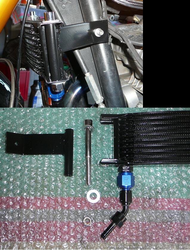

1) Tap a couple holes in the lower neck area to align with top cooler mount holes.
2) Tac weld a couple bolts on lower neck area to align with top cooler mount holes.
3) As mentioned, use side reflector holes for mounting a fabbed mounting bracket.
Earls cooler had side mounts, so fabbed side brackets & used side reflector threaded holes for securing each side to cooler.....
if it helps/provides some ideas....
