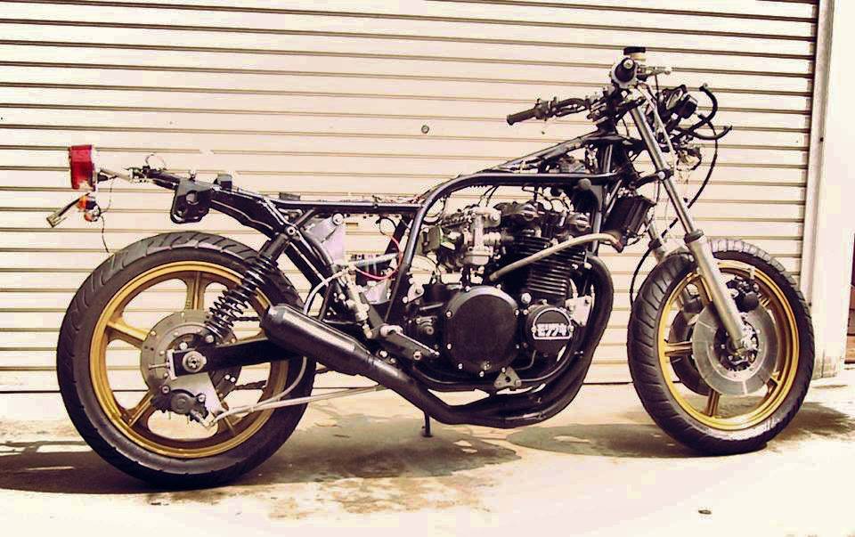

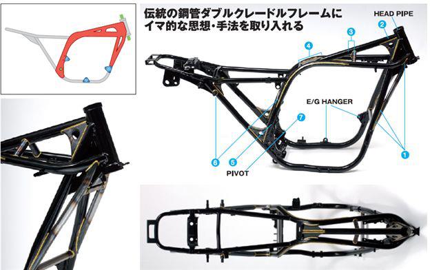

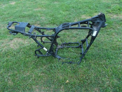

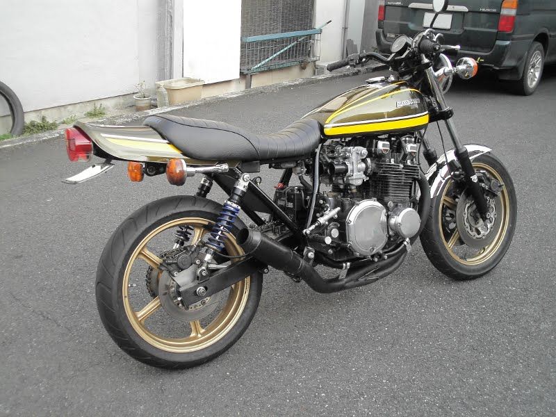

there are for sure many threads with this discussion giving important do's and dont's like"make sure you have engine or at least cases bolted into the frame and tightened up before welding bracing" here are a few angles...also i put many frame brace shots and plans and diagrams into the the many pages of the kz dragbike-streetbike thread here on kzrider....those pictures are a history of the differnt ways to brace these frames from the last decades...really worth a look
