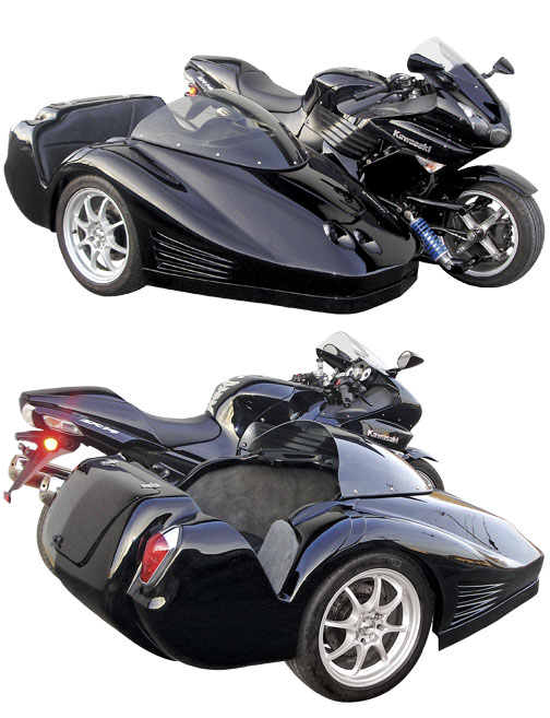

it is very common to use car tires with sidehacks.
they do not lean either direction(unless it is a leaning sidecar)so they can get away with running car tires.
i believe i would buy another rear wheel for your bike and send it to www.kosmanspecialties.com/
and have them widen it to fit the tire you want to run.
that way you know it bolts on and won't have any fitment issues.
here is a leaning side car so you fellers can see the difference.
hth,
hth,

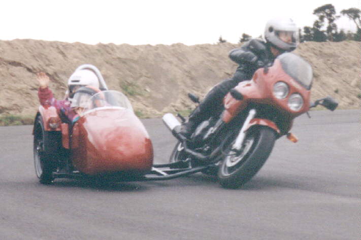

31 Jul 2013 15:38 - 31 Jul 2013 15:38531blackbanshee wrote: it is very common to use car tires with sidehacks.
That is only true is sissy types. :laugh: :laugh: :laugh: When I worked in D.C. I saw D.C. cops lean their sidecar bikes WAY over on the left hand turns every day on Rock Creek Parkway. But I suspect if you're gonna be a cop in our nation's capital you better come equipped with industrial strength balls. :laugh: :laugh: Here's a pic of a D.C. cop with a mild lean; I wish I had pics of some of those guys that were really flying high; they were so used to doing it they thought nothing of it.
Attachment 00000_2013-07-31-3.jpg not found
