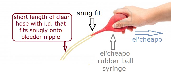

When filling the brake system with fluid, may use an inexpensive rubber ball style syringe with a short hose attached to the end which connects snugly over the bleeder nipple.
M/C reservoir is uncovered (to watch the fluid rise up inside).
Bleeder nipple is slightly loosened.
Brake hand lever isn't being squeezed.
Suck a load of fresh "unskaken" fluid into the syringe, remove from fluid and press out the air, and re-immerse and re-suck, repeat as needed until the syringe is almost full.
With the tube pointing upward, squeeze slight pressure on the syringe to expel all air (fluid is barely escaping from end of attached hose).
Holding it in this condition (no air in the syringe or hose), attach the hose onto the bleeder nipple.
Squeezing the syringe will now push fluid from the syringe through the hose and into the bleeder nipple.
Don't release squeeze pressure on the syringe while attached to the loosened bleeder nipple.
If more fluid becomes needed in the syringe, tighten the bleeder nipple before relaxing and removing the syringe.
Refill the syringe and resume the filling process as earlier described.
As fluid fills the system, it will eventually appear and rise up inside the master cylinder.
When the M/C becomes filled, tighten the bleeder, without having relaxed pressure on the syringe.
Then remove the syringe and hose.
Normal bleeding procedure should now expel remaining air from the brake system.
