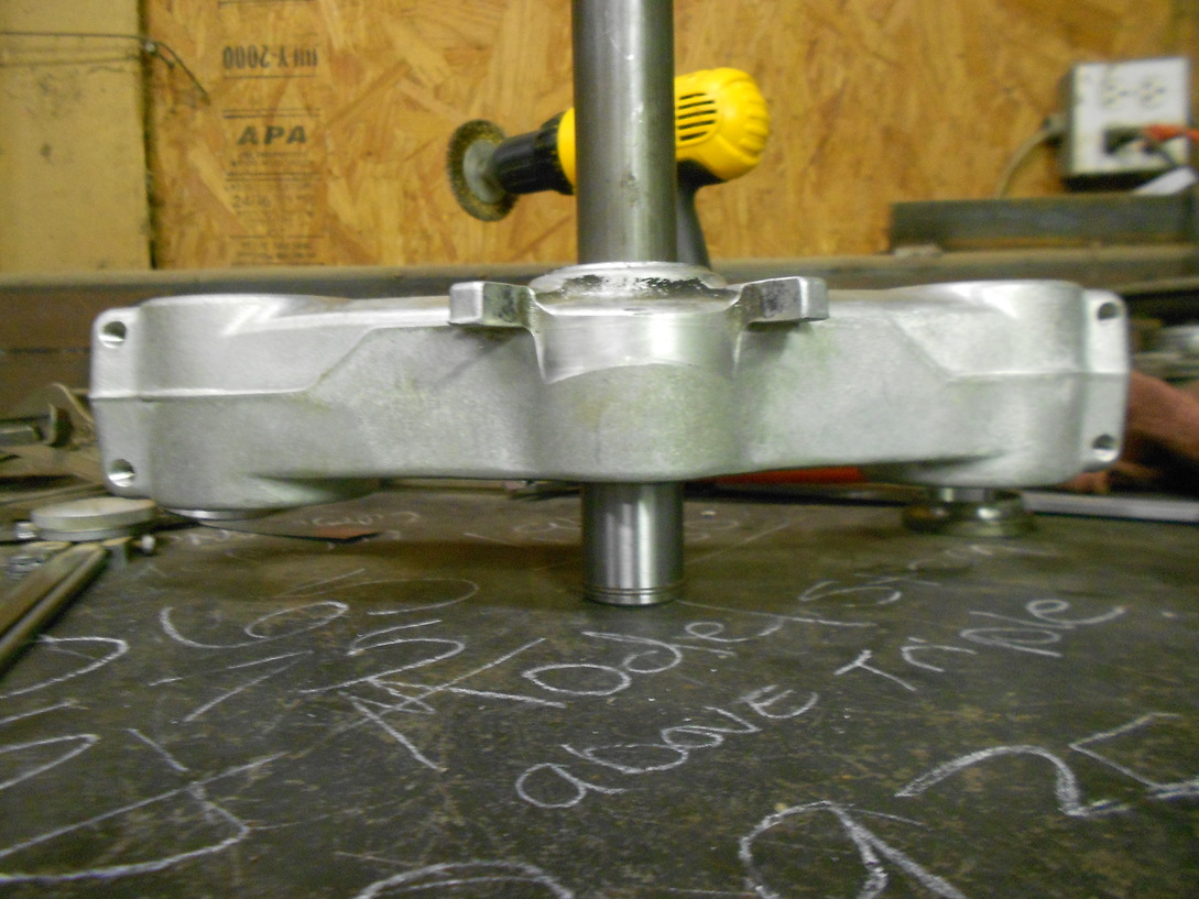

here is a bsa stem that was brazed into the lower triple.
[attachment:1]C:\fakepath\mortonsktmbsatriples (10).JPG[/attachment]
i parted the stem away with a port-a-band saw.
then turned the old chunk of triple that was left into the step i needed to register in the counterbore i machined into the ktm triple.
later model kz's 81 or so and up,have aluminum lowers and the steel stems have a snap ring.

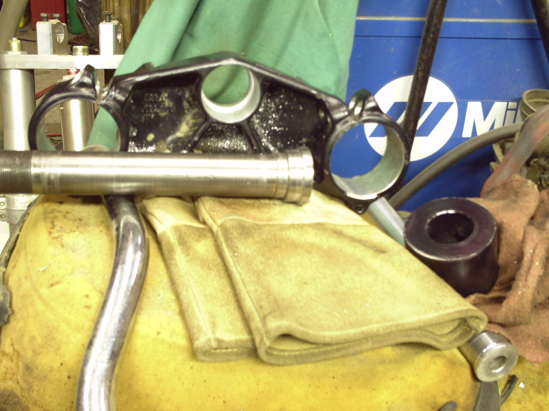

[attachment:2]C:\fakepath\boostableszx10tokztripletreeconversion (9).JPG[/attachment]
same deal cut a counterbore in the lower for it to register on.

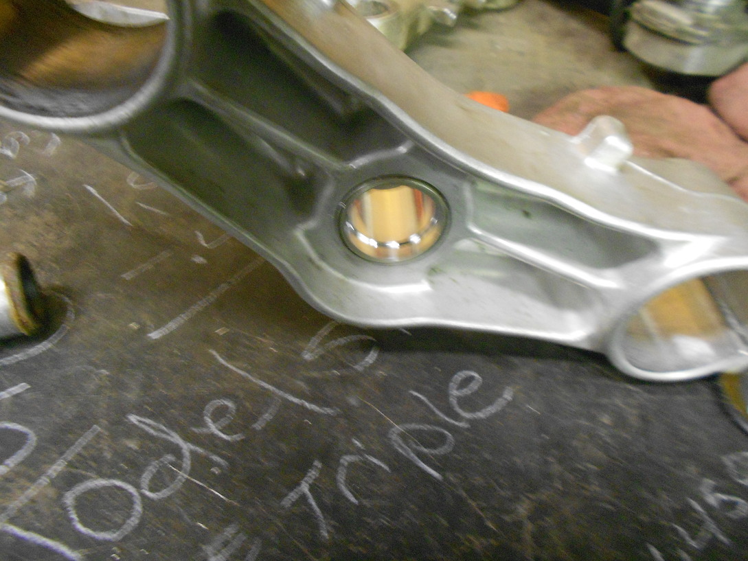

[attachment:3]C:\fakepath\boostableszx10tokztripletreeconversion (
.JPG[/attachment]
there are more pics in the
hth,
hth,
hth,
hth,
