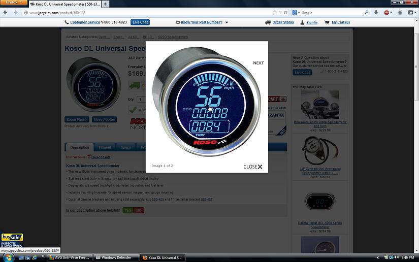

#584536
You'll be limited by the Speedometer Drive which will be for a 19 inch wheel, or there's an 18 inch Speedo drive kit from a German Company.
I'd prefer this.
