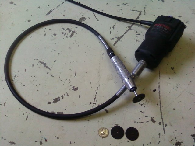

28 Apr 2013 16:49loudhvx wrote: When I used the chisel method, it messed up the bottom seal. If you are replacing the seal, obviously, it doesn't matter.
Now I use the dremel, and it preserves the seal.[/quote
:huh: air motor with a thin cut off wheel or an actual tiny dremel tool ?

- bluej58
- Posts: 2474
- Thanks: 507
Re: Best way to remove bottom race from lower triple??
28 Apr 2013 19:02 - 28 Apr 2013 19:15
I prefer using these small reinforced cutters and my Dremel with a variable speed foot pedal.
anything with a thin cut off wheel should work.
ALWAYS WEAR SAFETY GLASSES !
Also good for polishing
