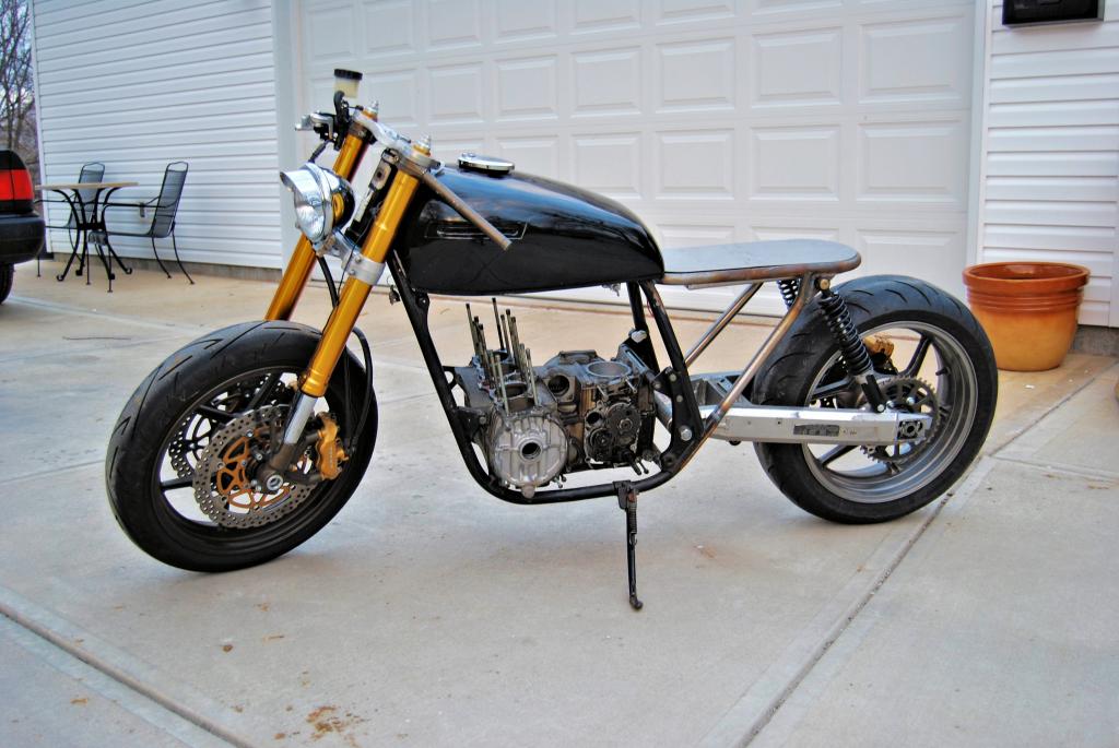

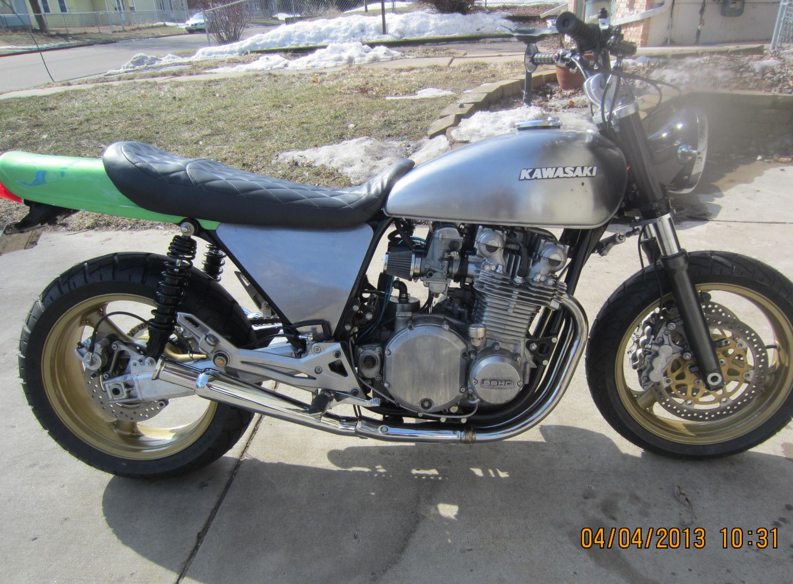

www.kzrider.com/forum/11-projects/478810...r?limit=20&start=120
there is a link to a thread where we modded a zx6/zx636 swingarm to fit a kz.
i and others have modded these arms to fit the kz with good results.
how big a back tire do you want to go?
here is kzr member wycowboys kz with a zx swingarm.
and here is kzr member dnels 650 with the zx swingarm mod.
