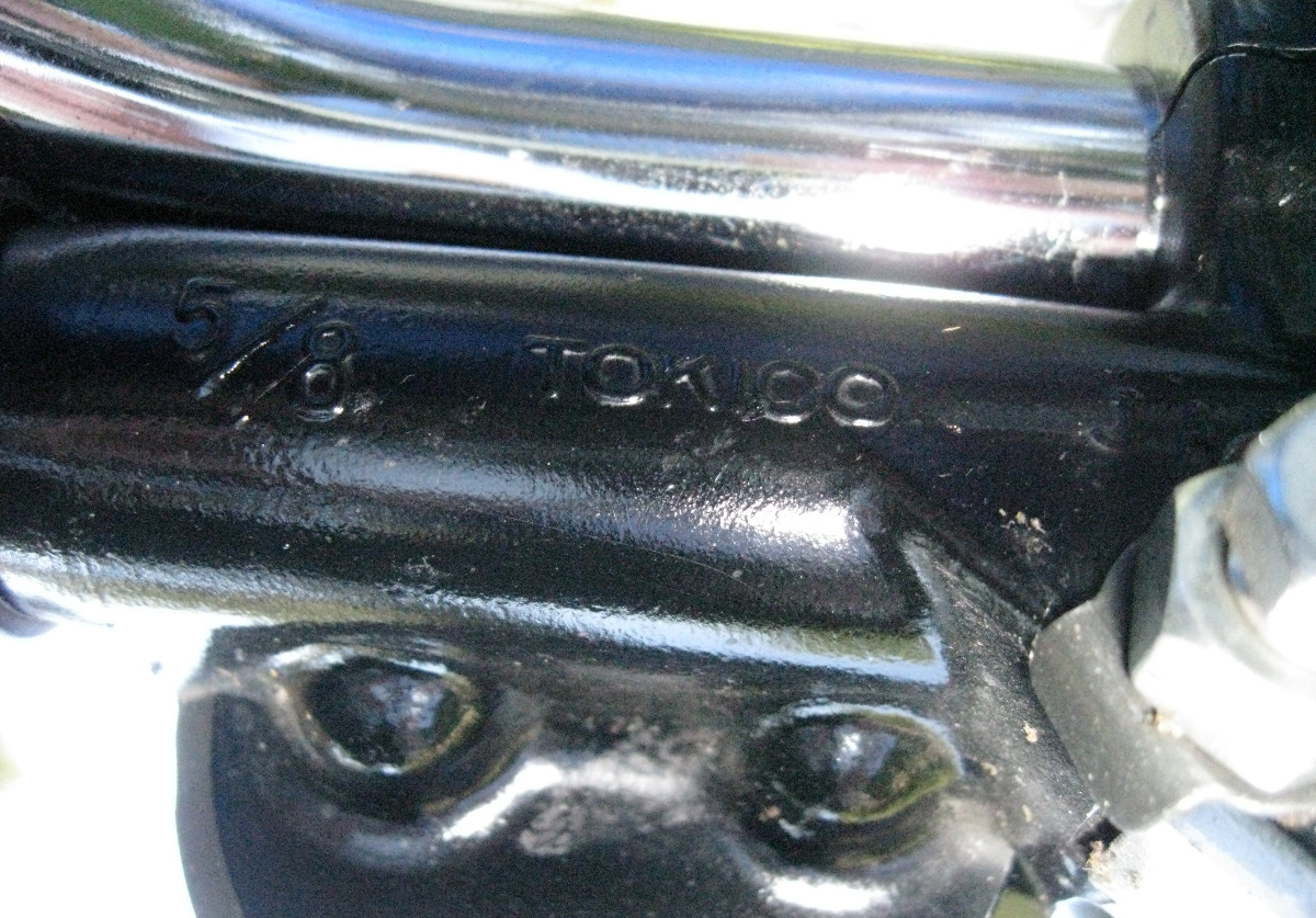

Does your bike have dual front disks? Mine does and the bore is 5/8" or 15.875mm. I believe that is the standard size bore for KZ bikes with dual front disks. Ed

bromz wrote: I put a new master on my front brakes and rebuilt the calipers and new braided lines and I still have a soft lever. Could the bore on the new master be to small. The bore is 14mm im not sure what the original bore is.
Yes, 14mm bore is for single disc.
Using it with dual, you will get the spongy feel.
