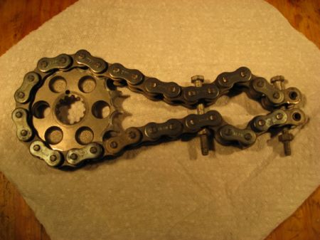

Am thinking that the item being referred to as a "Bar-Tool" is a short extension to fit over and add slight leverage to an end wrench or maybe a shock adjuster tool.
A much longer breaker-bar may be needed to loosen the counter shaft sprocket nut, which is sometimes notoriously tight and difficult to break loose.
If the nut is already sufficiently damaged to prevent gaining a hold with a socket for removal (with a breaker bar or air hammer), it's likely too damaged for adequate tightening when later reinstalling the sprocket.
Heat from a butane torch might help loosen the nut, if red lock-tite was used when assembled.
A hammer and a steel cold chisel may be used by allowing the chisel point to dig into edge of the nut while pounding on the chisel with the hammer.
Might also use a cut-off wheel or Dremel tool to carefully slice into the nut.
In any event, wear eye protection.
Here's one option for holding the sprocket in position while attempting to turn the nut.
