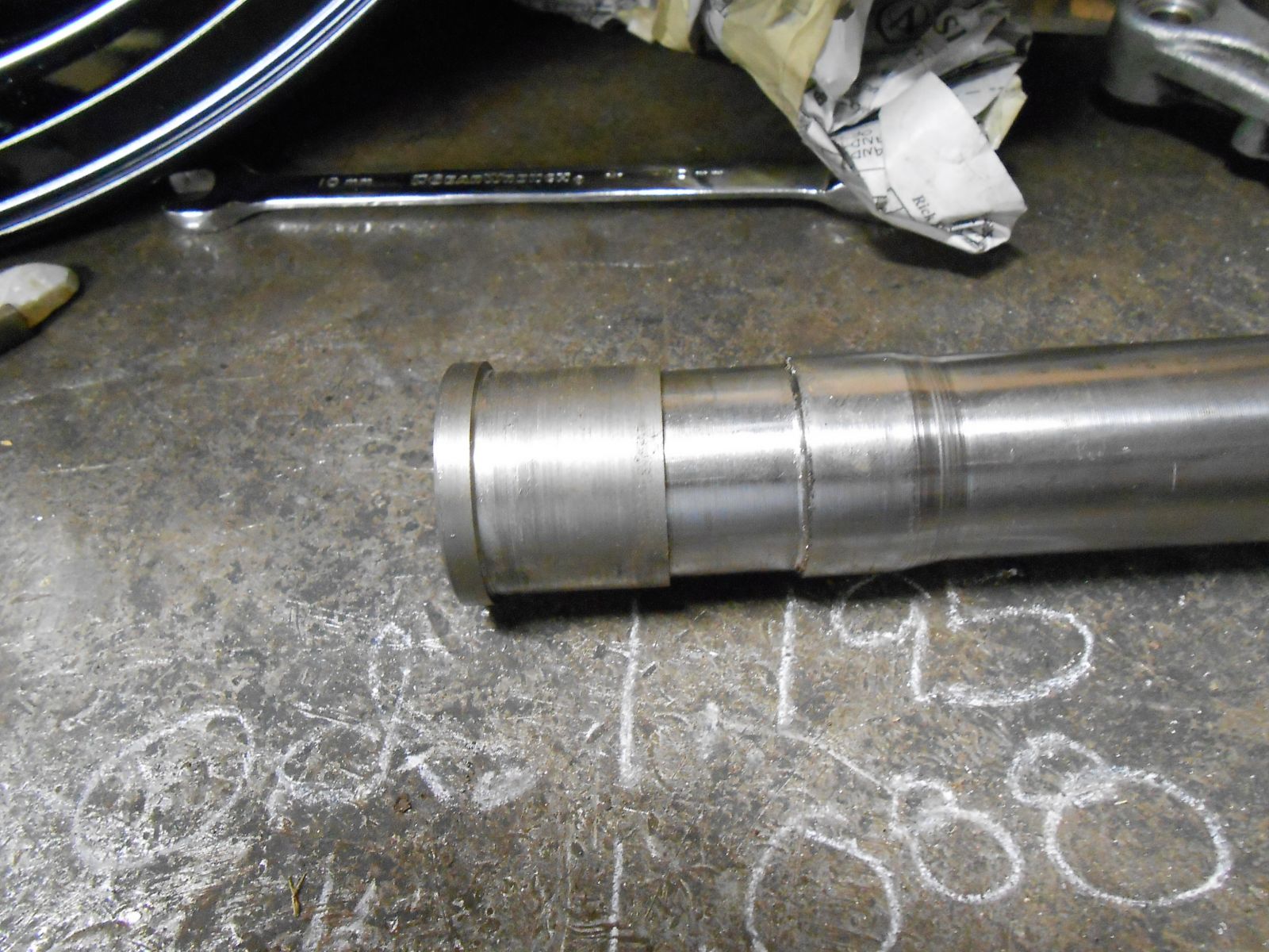

05 Jan 2013 14:04531blackbanshee wrote: the sleeves are thin but once they are all pressed together it no longer matters.
because they support each other.
if it makes you feel more cozy weld a few passes around the end of the kz stem and machine it down and leave a step on it so that your stem is one piece.
i have done a bunch by machining the stem in while still in the triple and using it as the bushing.
here is a triple getting the stem bored.
That´s hard core machining Leon !
Smart move mister...welding a few passes and machine it down feels oh la la... :woohoo:
But what´s with the "step" ? You meen as a section at the end that stops the stem from passing threw the triple ?

06 Jan 2013 13:20Arnold wrote:531blackbanshee wrote: the sleeves are thin but once they are all pressed together it no longer matters.
yessir like this,

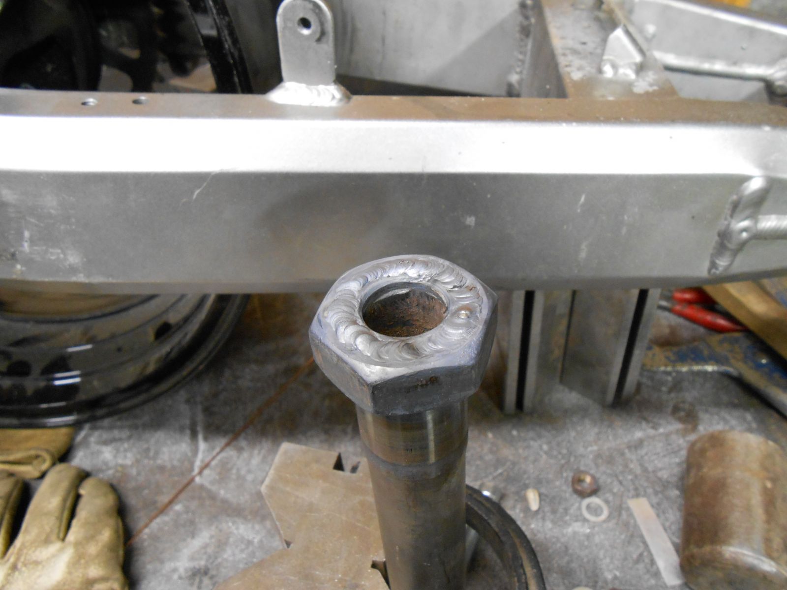

- Posts: 7442
Re: Which way press out triple tree stem ? (KZ 1100 ST
06 Jan 2013 13:28 - 06 Jan 2013 13:35
that one was a (thinwalled
)sleeve i machine out and installed.
one time i bored a nut out,welded it on and then machine it down for the step.
