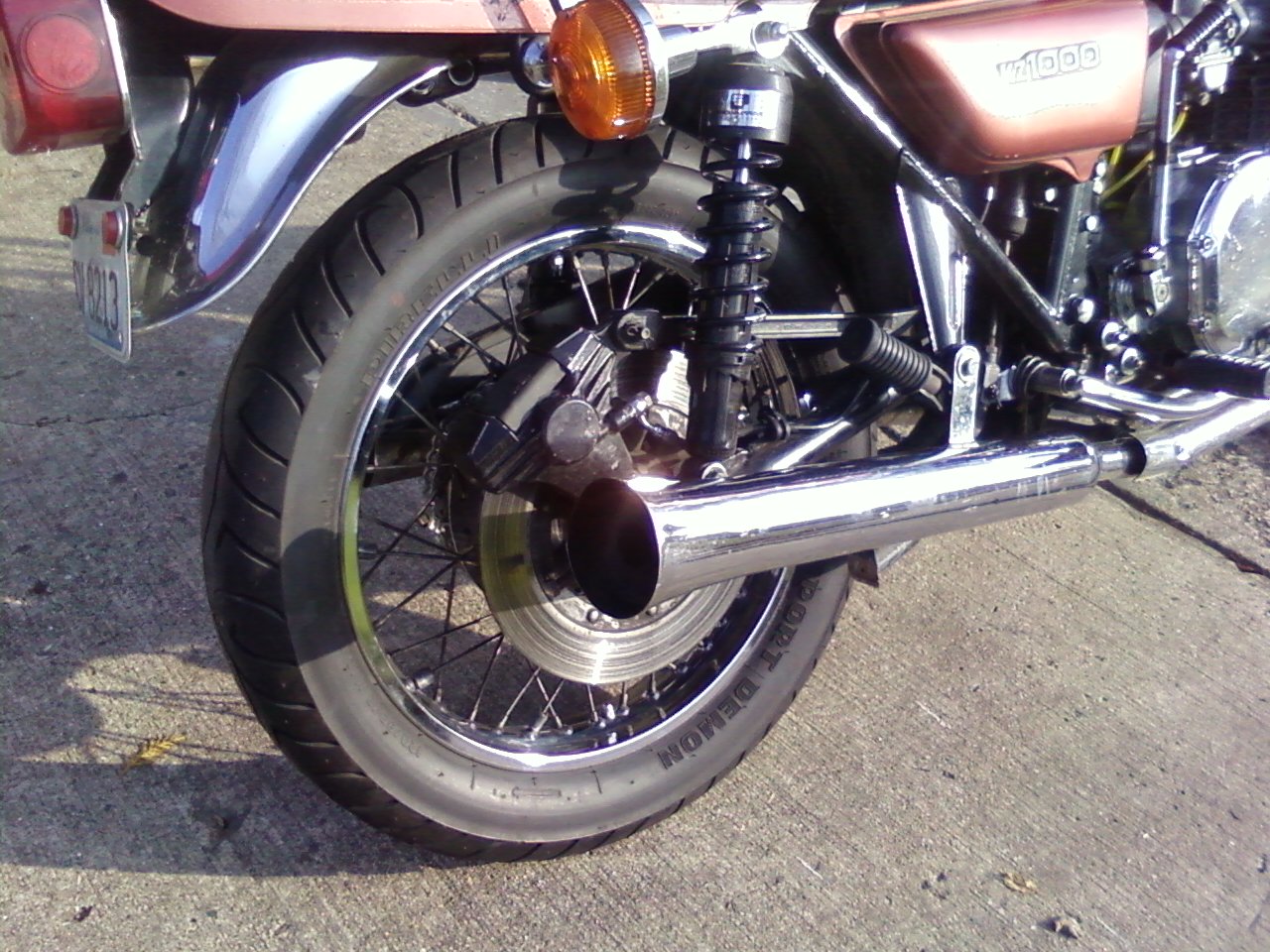

The back tire is wider than stock and looks beefy enough for me .
You may find that this wide a tire will rub on the plastic chain guard a little but there is room to trim it for clearance and it is still plenty strong , this is a mod.that I did many years ago and have had no problems .
I'll add a picture later today.
