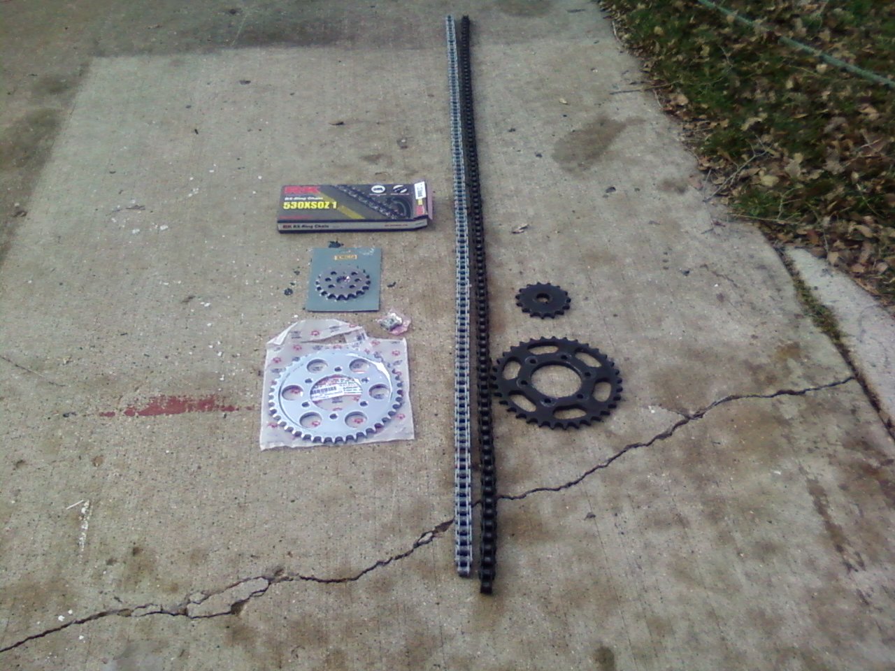

So I swamped out my thirty year old macho chain for a 530 girly man setup, what a difference .
The old one was creating a odd vibration that was starting to make me real nervous , to be fair , any new chain would have been a big improvement but I think I feel a little more pep running through the gears,tested to triple digits :whistle: nice an smooth.
Also I have a slight rise in the rpm , I'm told it's something like 40 rpms at highway speed that accounts for some of that.

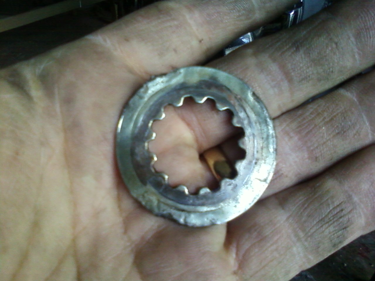

The only problem I had was that the new lock washers tang that is supposed to fit in a hole on the new sprocket didn't line up so I had to reuse the old washer that works differently , no big deal but if you order a set make sure that they check that before sending it out.
Thanks again guys , couldn't be happier
JD
This is the old washer that I reused
look how much the old chain had stretched
JD
