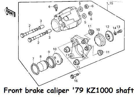

Here's the front caliper parts diagram from kawasaki.com.
Am thinking #3 are the "sleeves" which don't have a separate part number.
The #11 dust seals are important to keep grit and road gunge away from the sliding surfaces where the caliper floats back and forth along the shafts.
