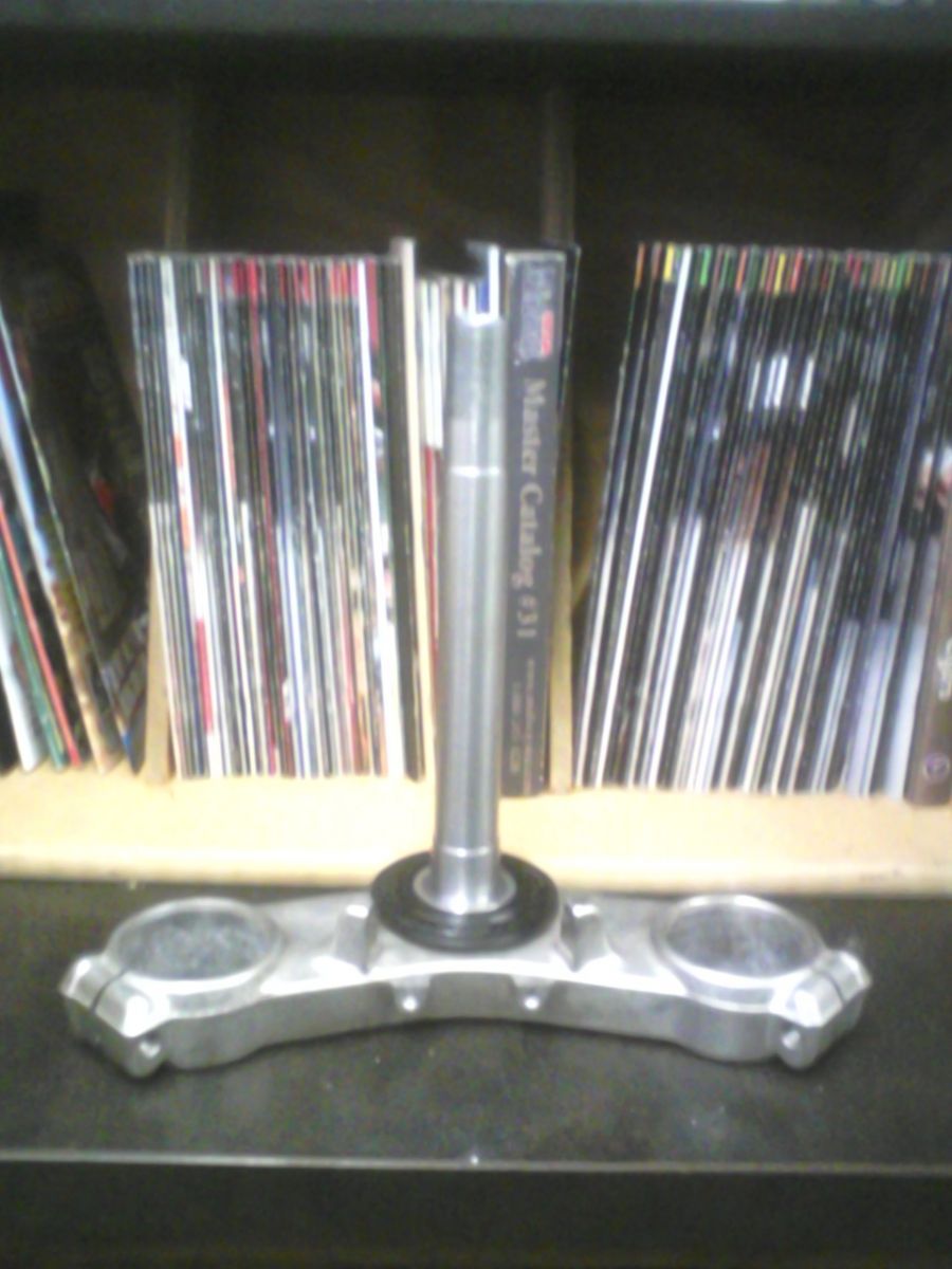

Landfair check out this website (
www.allballsracing.com/index.php/forkconversion
). You type in your bike (model and year)and it gives a list of conversion bearings for different forks then just find the forks you want to use (stem length might still be off). I've been involved with 5 stem swaps and what been done is to press out the existing stem and replace it with a custom stem that uses stock bearings (or in your case the tapered conversion bearings). Some will make a adapter ring to fit your stem into the newer trees. I personally don't like this approach not thats there is anything wrong with it, I just prefer to be able to put everything back to stock if I choose. The picture is a tree from a 2000ZX7 with a stem for a 1982-85 GPZ750 (and others)
I hope this helps. Pictures please
