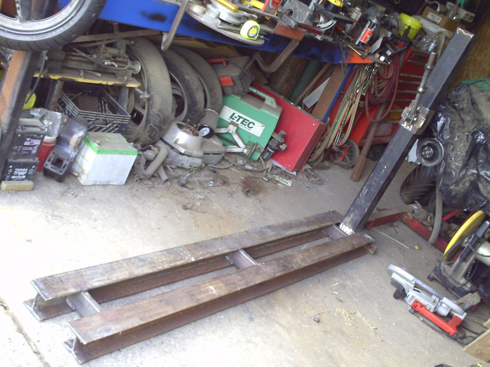

here is my frame jig.
here is a patient getting a new backbone.
sorry about the half dressed hoodlums :pinch: .

Geez Leon, where'd you get those I beams from. That thing looks stout.

He probably found them in nebraska,damn sooners! :laugh: :laugh: :laugh: :laugh: :laugh:
