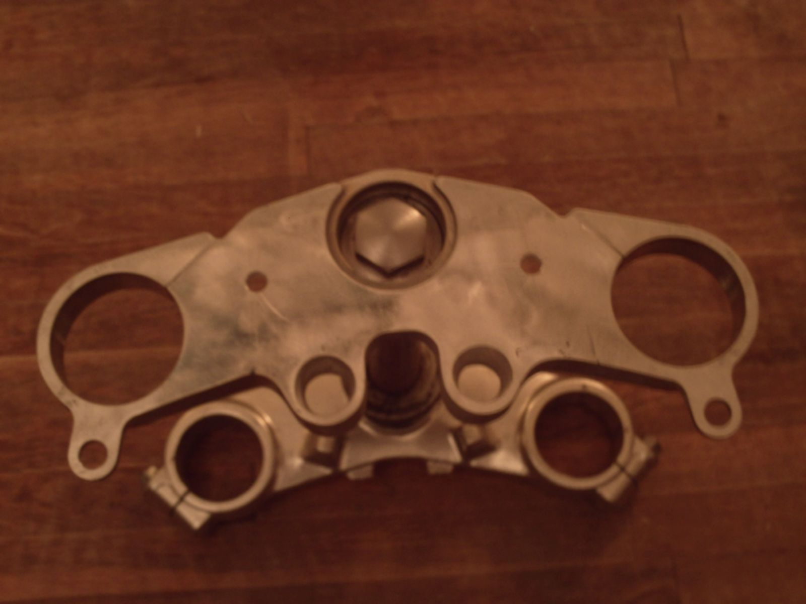

steve,i used aluminum(6061) and cut a slot in them.they could be made from alum or ss,they could have a lip if it helped you to sleep at night :whistle: :lol:
here is a zx9 that i cut the ignition sw.
loop off from and machined new bungs and welded them on.
