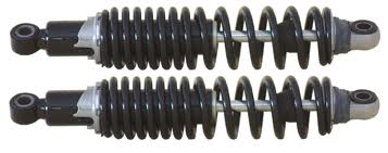

Here's a pic, I think they are the same as the set you are buying. I'm not much of a pavement scratcher but the shocks work fine and they look good too.

those are dial a rides...if you have not already...lift that rubber cover under the top mount bolt to expose the dial...1 is soft...4 is hardest....it must be clicked all the way on each number ,no half dials etc...or it will pop the valving....i just tossed the rubber cover so i can adjust at a stop sign with one finger....pot holes around town with a passenger,1 softens their getting beat up back there...country road and hauling ass alone...4 stiffens them for less pogo effect imo...
