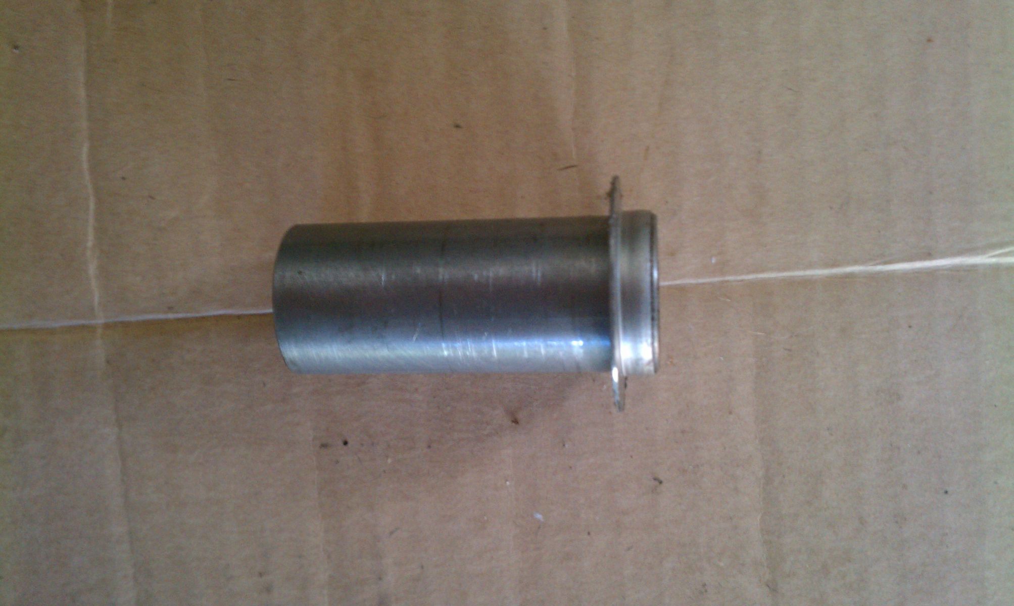

Now, next issue. I couldn't tell how the spacer was oriented between the bearings. Should the ridge face the sprocket side or should it face the drum side. I have seen parts diagram showing each way. But I think for my bike it should face the sprocket side, but for an LTD the disk side (mine is drum). Anybody know? Functionally I don't think it matters, but for removing the bearings the next time (if there ever will be a next time), the side without the ridge is the side to push out of the way when tapping the bearing out. I'm thinking that is why only one ridge exists. Any ideas?
