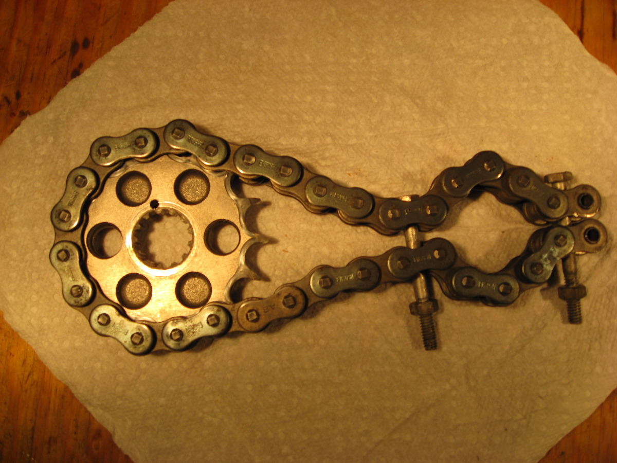

You can hold the front sprocket using a piece of chain and 2 bolts (see pic) and not need a 2nd person holding the brake and not stress the brake system. That loop between the 2 bolts goes around the swingarm. Ed
