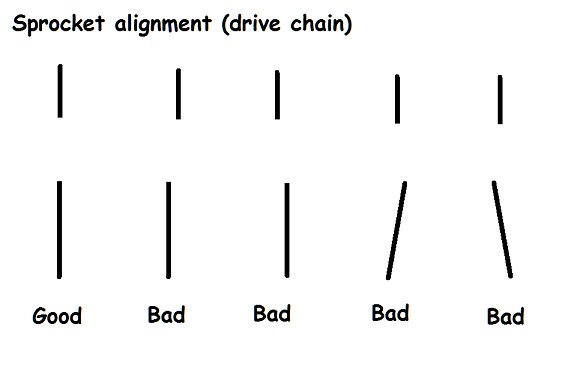

As advised by Z1E:
Avoid putting non-motorcycle (industrial) chain on motorcycles, these chains are NOT designed for running at speed and enduring the harsh stresses put on them by a motorcycle.
www.z1enterprises.com/reference/chaintypesize.aspx
It's also important to assure that the rear drive sprocket is perfectly aligned with the counter-shaft sprocket.
