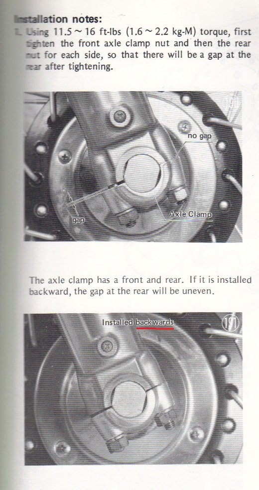

Those front axle clamps will have a gap at the rear when the front part of the clamp is tight. Do not try to eliminate the gap, as you will break more of the studs.

Thanks for the help guys. I ended up getting the rest of it out with vice grips. I also didnt know that the front of the clamps went on first with a gap in the rear. Very good info. Thanks!

The cap might have an "arrow" casted on its bottom side.
The arrow should point forward when correctly installed.
When installing the clamp (with arrow pointed forward), first tighten the front stud nut (no gap where cap attaches), and lastly tighten the rear stud nut (which still has a gap -- it's the gap that allows torquing the cap to its specified "grip" onto the axle).
Cap correctly installed -- see equal thread exposed on studs.
Cap installed backward (incorrectly) -- see more thread exposed on front stud and less thread exposed on rear stud.
Last edit: 25 May 2012 08:05 by Patton.
