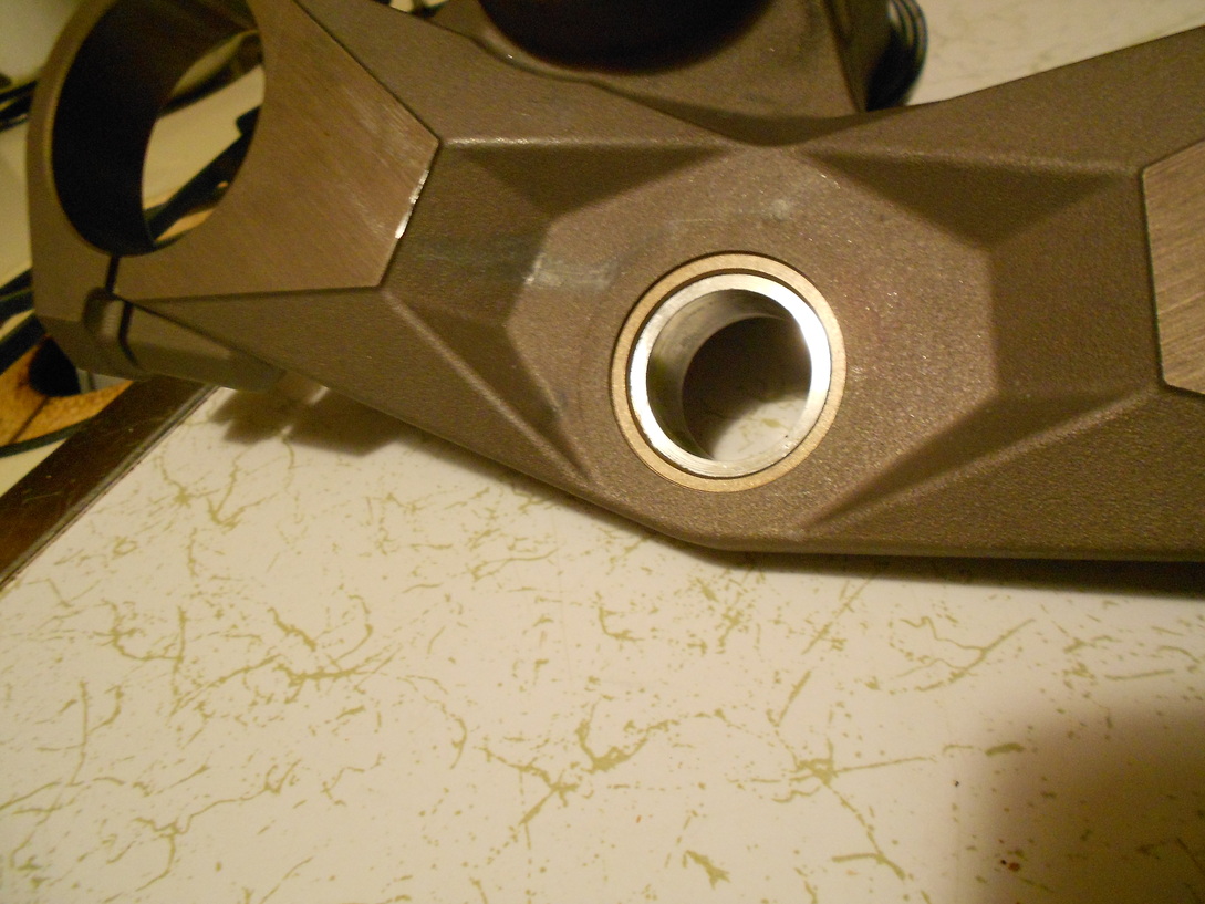

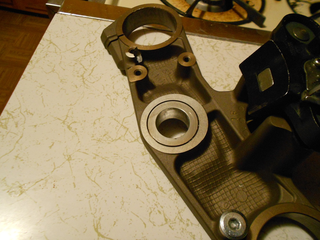

Les I was referring to the bushing that old man rock used. Even if I have the zx6 stem machined down to the kz size won't I still need a bushing or sleeve for the top tripple? Help? I weld and fabricate for work so moving the tank is do able. I don't have a lathe so I'm going to have to pay for machine work. So I'd like to get it right the first time. I posted a link to my fork pic. I can't seem to get it into the thread.

here is a zx636 upper triple that i converted for boostable.
the pic shows the bushing i had to make and press in to get it to fit the kz stem.
bottom
top
shoot me a pm if you have any ?'s
bottom
top
