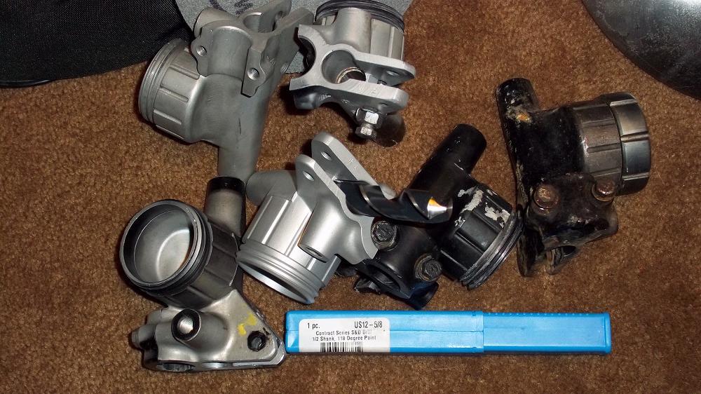

Yes it will work in physics. But it will be spongy, and the lever will pull all the way to
the handle bar.
That is why all the Z1 and H2 guys want the coveted 5/8" bore master cylinder fo
the dual disk conversion.
I am assuming you have this early Z1 KZ900 style master cly.
I am working on some here.
How is this for a story:
I finally bug a family member to bore these out. I tell him to 5/8"!
Stock bore is 14mm.
So he being the professional machinist that he is, he feels that it should something
under american size 5/8"! being of metric, japanese style. So he thaught he was correct and told me so.
So me being a nice guy said thanks alot! Wow you did me a favor.
So now I have 3 bores that need to be bored another .005 -.010" I will probally finish bore
them with some 220 wetsand paper.
the handle bar.
Stock bore is 14mm.
