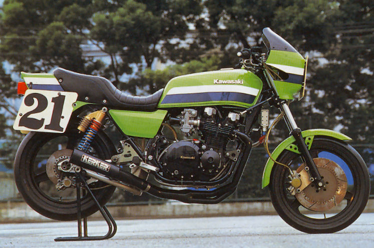

17 Feb 2012 20:18 - 17 Feb 2012 20:22mtbspeedfreak wrote: You can definitely get the parts you wanted for less than buying a whole nother bike. Post something on the Wanted section.
Also, why do you want a rear disc? It doesn't help you stop any better than the disc and the whole setup weighs noticeably more.
Ever wonder why....
Attachment Eddie_Lawson_Kawasaki_2012-02-17.jpg not found
Last edit: 17 Feb 2012 20:22 by 650ed.

Re: to buy or not to buy? 1978 kz650C
17 Feb 2012 20:27
Who needs a rear disk when you can power out of a corner like that? :lol: :lol:
650ed wrote:mtbspeedfreak wrote: You can definitely get the parts you wanted for less than buying a whole nother bike. Post something on the Wanted section.
Ever wonder why....
17 Feb 2012 20:54
Obviously the stock swingarm, disc, caliper and rim. My fault....
17 Feb 2012 20:59 - 17 Feb 2012 21:01
mtbspeedfreak wrote: "Obviously the stock swingarm, disc, caliper and rim. My fault"
Right - custom rear wheel, swing arm and brake. So since they could use any kind of brake, why would they chose disk over drum? Seems to me since they were going all-out to win races, and money was not a serious obstacle, they would select the components that would give them the best chance of winning races. Maybe I'm wrong. Maybe they couldn't afford a drum brake.
17 Feb 2012 21:36
We're over complicating things here...
The stock drum brake wire wheel, drum brake and drum brake specific swingarm are lighter than the stock mag disc brake mag wheel, disc rotor, caliper and disc specific swingarm.
I've locked up my rear drum wheel on more than one occasion so the performance benefit of a stock disc brake conversion is negated by the increased weight difference.
Of course when money is no object, like an AMA superbike when you run true magnesium alloy wheels in a race setting, yes they have rear discs. And there's also a reason why you can't get drum rear brakes after '76.
