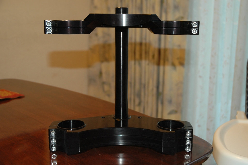

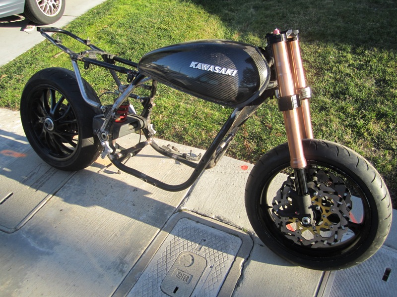

I'm using a '06 GSXR1000 front end on my bike, the twist being I purchased custom triple's from another member here that alows closer to stock ride hight and factory fork offset for OEM turning radius. The stem is custom and uses the factory bearings for a direct swap. Definitely NOT the least expensive route, but it was one of the few splurges I allowed myself for this build.
Custom triple trees compliments of irishwill :woohoo:

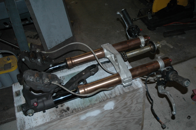

20 Feb 2012 15:022002 gsxr1000. Stem bearings are the exact same as the kz650
some milling on the bottom of the top triple and boom. Bolt on. Offset is bad, custom triples in the mix.
cbr929 clip ons
cbr900rr front wheel with 150/80/16 tire
cbr900rr rotors
zx7 rotors with custom spacers
ktm exc headlight without shroud
garmin gps use for nav. and speedo
love building motorcycles one headache at a time

A custom dropped top triple clamp is the easiest way. I gained quite a bit by going this route. Check out the picture porsche914 put up, you can see the Gullwing top clamp. He had custom upper/lower clamps made...I only got an upper.
