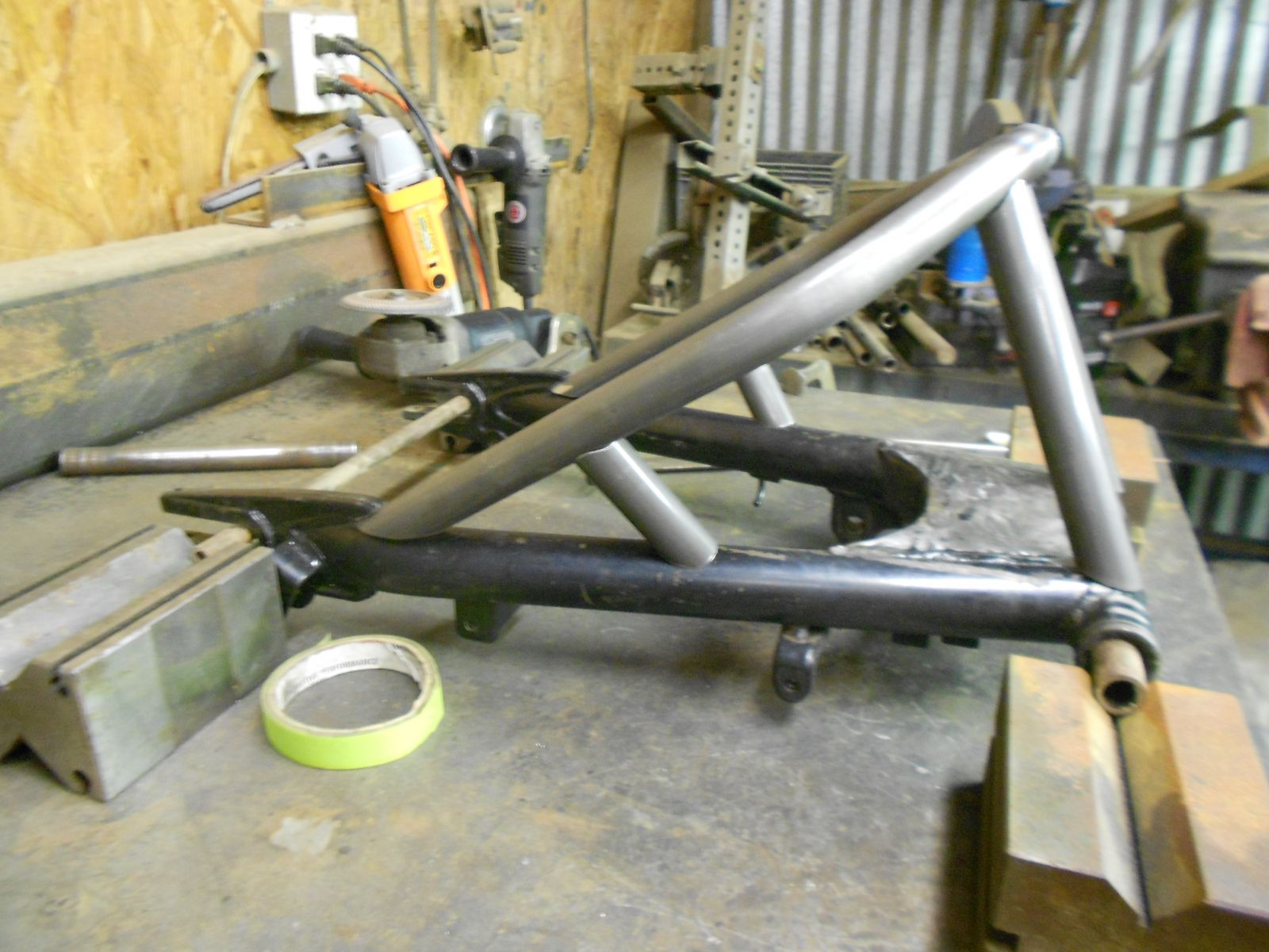

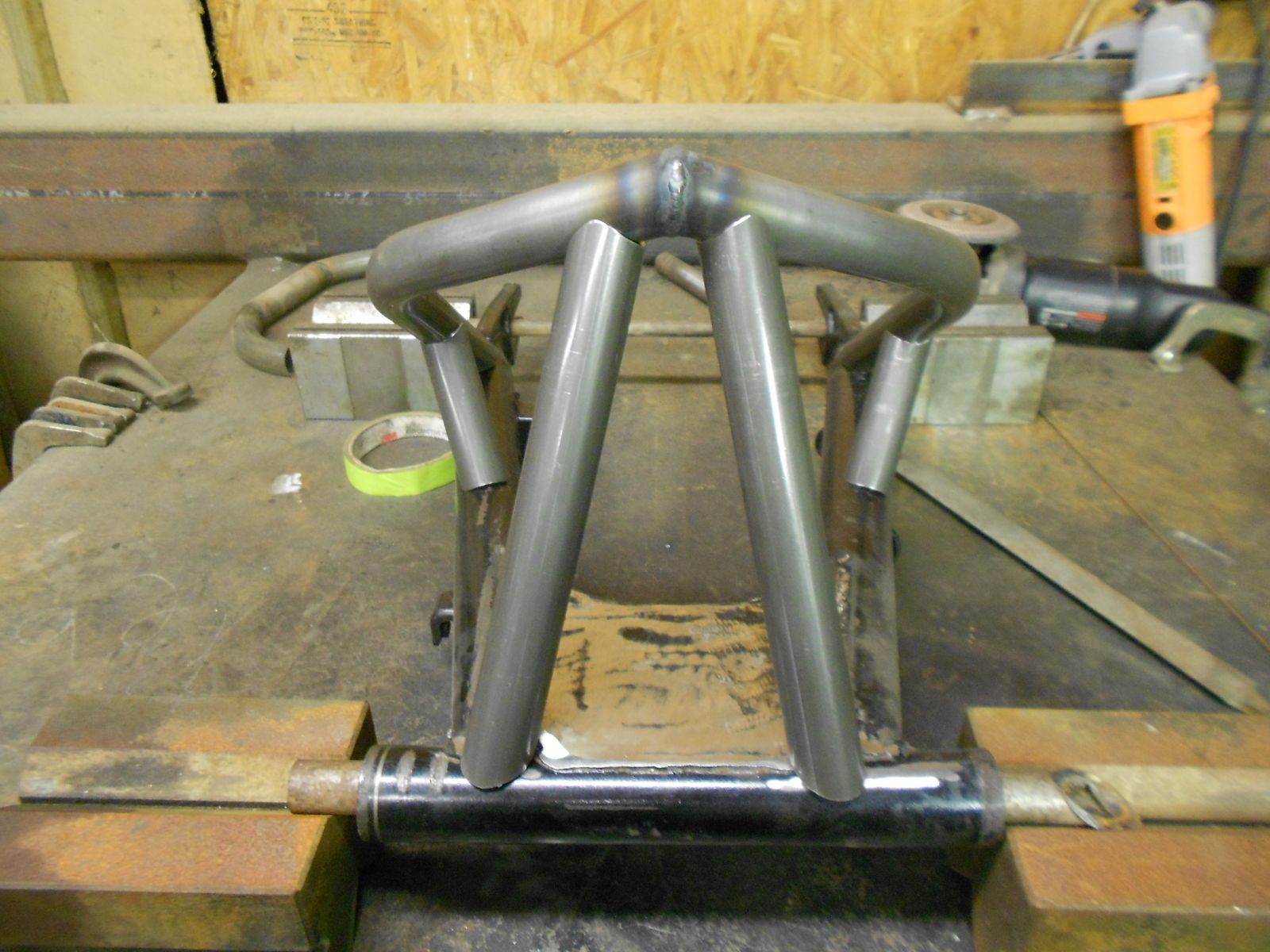

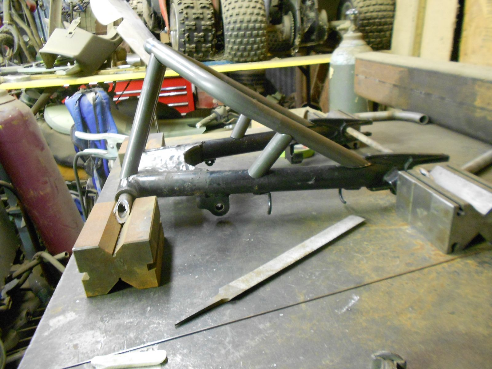

...well, I have some update photos. Thanks to Leon, he's welding up a swingarm for me. Enjoy, I sure am! Can't wait to get it mounted.
...thanks, Leon! You da man!

Leon is an artist no doubt!
