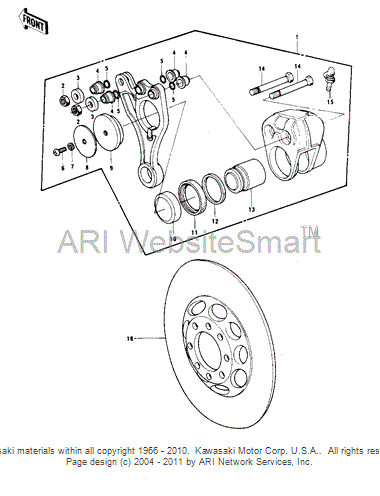

Your rear brake is a bit different than I was thinking, but still should come off with the two #14 bolts removed. Do you have 6-9 removed?
Post up a picture of wear you are having trouble.

04 Nov 2011 22:21silentchris wrote: ... have no means of pulling the wheel off ....
