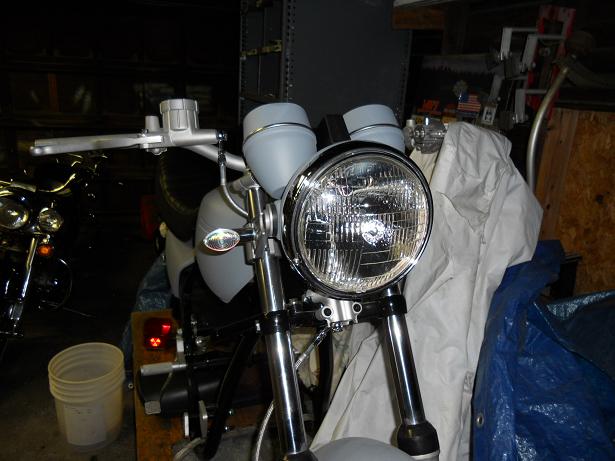

Re: KZ1000 braided brake lines (front)
18 Oct 2011 00:29
Use Google, measure them, you will spend hours looking. They are sold by the inch. 18-19-20-21-22
Chrome bango ends screw together. 45-90-180 degree angles. You say you have shorter bars, that throws out stock.
This top line is only 10 inch.
I made these local from "classictube.com"
