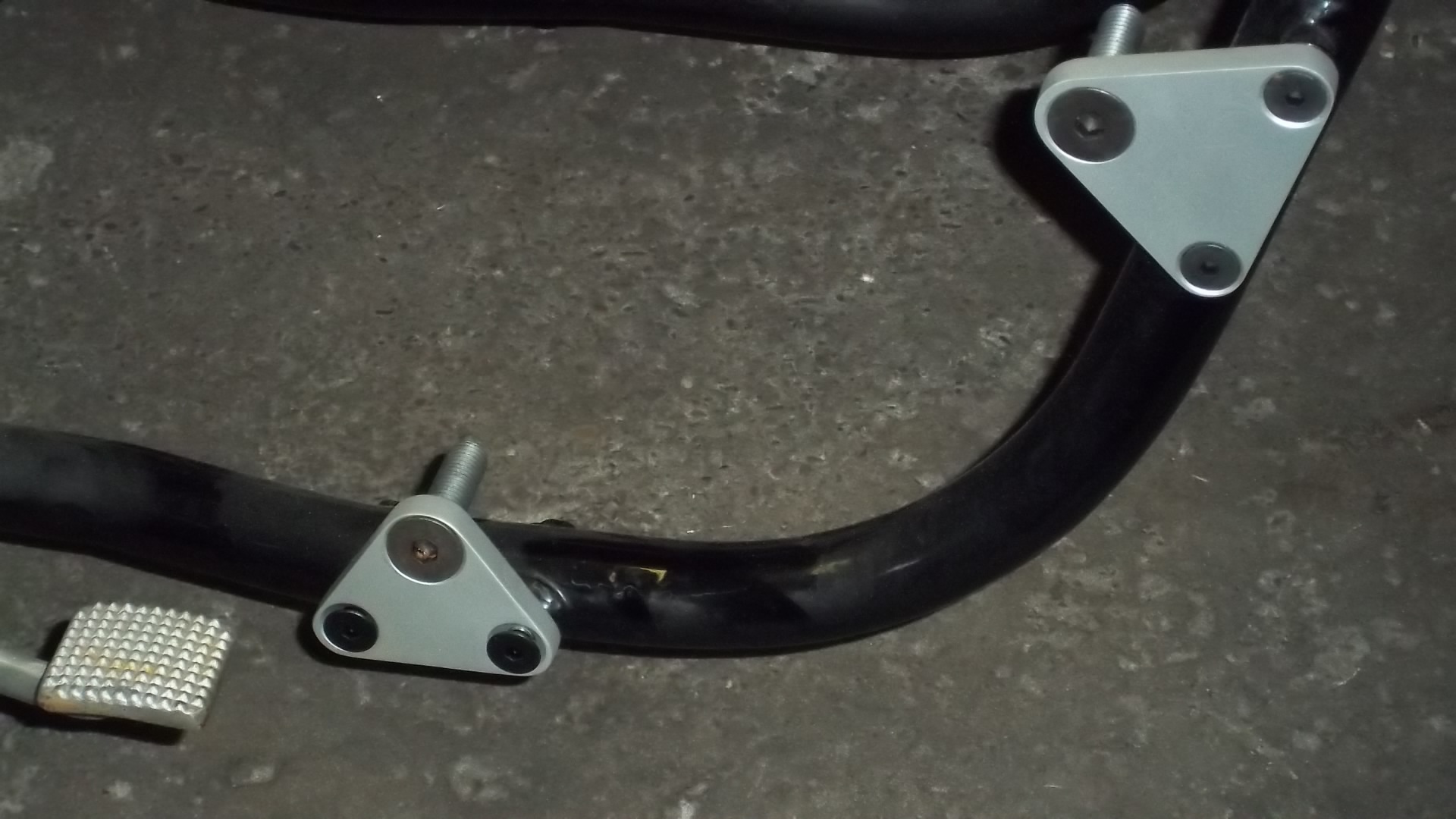

Hi, I always made flat aluminum ones. countersuck flatheads in them. 3/8" thick aluminum.
Just liked the look. Always had short distance, hot rod, drag bikes.
I also ruined the cases by threading 1/2" coarse bolts into them.
Never ruined any early # case though.
Check with "oinkjohnson" ebay name. He is always dismantaling dragbikes. He's cornered the market on parts? Always wondered if he has help with his bids???
Oink's like the gold & silver pawn shop. If you got an older dragbike that you can't sell, he'll buy it off you for 1/2 price.
Whatever? Here is a pic of mine
