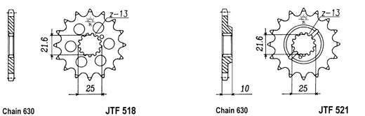

Might be mistaken, but thinking the Z1's original 630 non-o'ring final drive chain (with the automatic oiler) was fitted to a non-shouldered counter shaft sprocket.
The non-o'ring 630 chain was thin enough to allow clearance between its side plate links and the transmission cover behind the sprocket.
When replacing the non-o'ring 630 chain with the wider o'ring 630 chain, there wasn't sufficient clearance behind the counter shaft sprocket. Hence, either a shouldered sprocket was necessary, or fitting a washer behind the non-shouldered sprocket was needed to add clearance behind the sprocket in allowing for the wider 630 o'ring chain.
The original Z1's automatic chain oiler was discontinued early on, but am uncertain which later model thereafter adopted the oem o'ring 630 chain.
On Z1E's site, the non-shouldered counter shaft sprocket is listed for Z1~KZ900, and the shouldered oem counter shaft sprocket is listed beginning with the 1977 KZ1000. (See image below).
Also on Z1E's site, the conversion from 630 to 530 counter shaft sprocket requires using a washer behind the 530 sprocket (presumably because a shouldered 530 counter shaft sprocket isn't yet available??
Which seems consistent with o'ring 630 and o'ring 530 being about the same width, or least close enough to where both sizes require a shouldered counter shaft sprocket or a washer behind an non-shouldered counter shaft sprocket.
