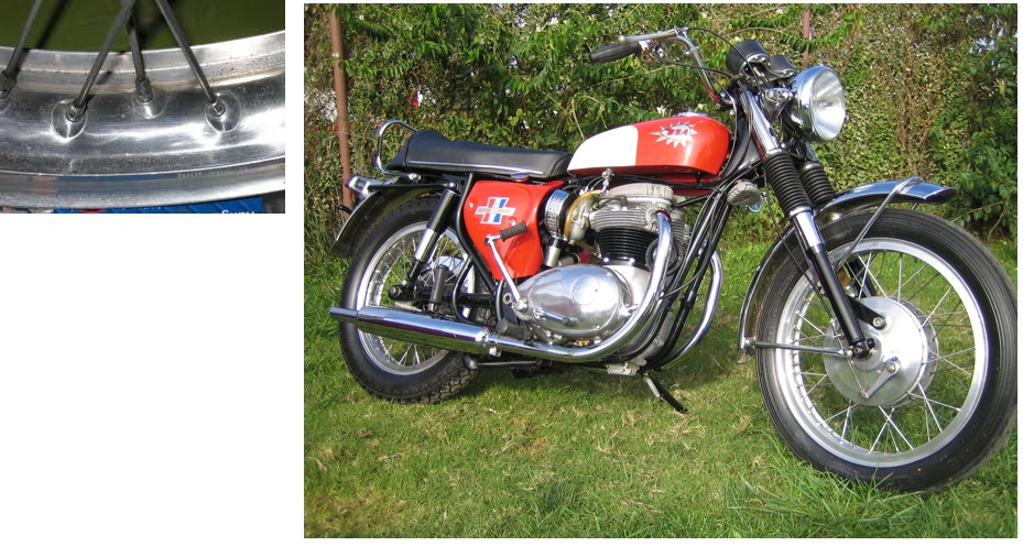

Is this what you mean by a shouldered rim?
I believe it is either a D.I.D. or a Buchanan's Sun Rim. I think it was stock on the 82 KZ650 CSR. I do like the look of it. Front matches. The guy I took it to did not like the back tire and rim locks one bit when mounting a new Bridgestone.

The way the lady on the phone at Buchanan's broke it down for me was that Excel offers both shouldered and non-shouldered rims, the only difference being looks because both will need a tube. Apparently back in the day a "shoulder" was added to the inside edge of the rim to give the rim extra strength. But I am definitely no expert.

15 Jul 2011 14:52Apparently back in the day a "shoulder" was added to the inside edge of the rim to give the rim extra strength. But I am definitely no expert.
You may not be an expert, but you hit the nail on the head
