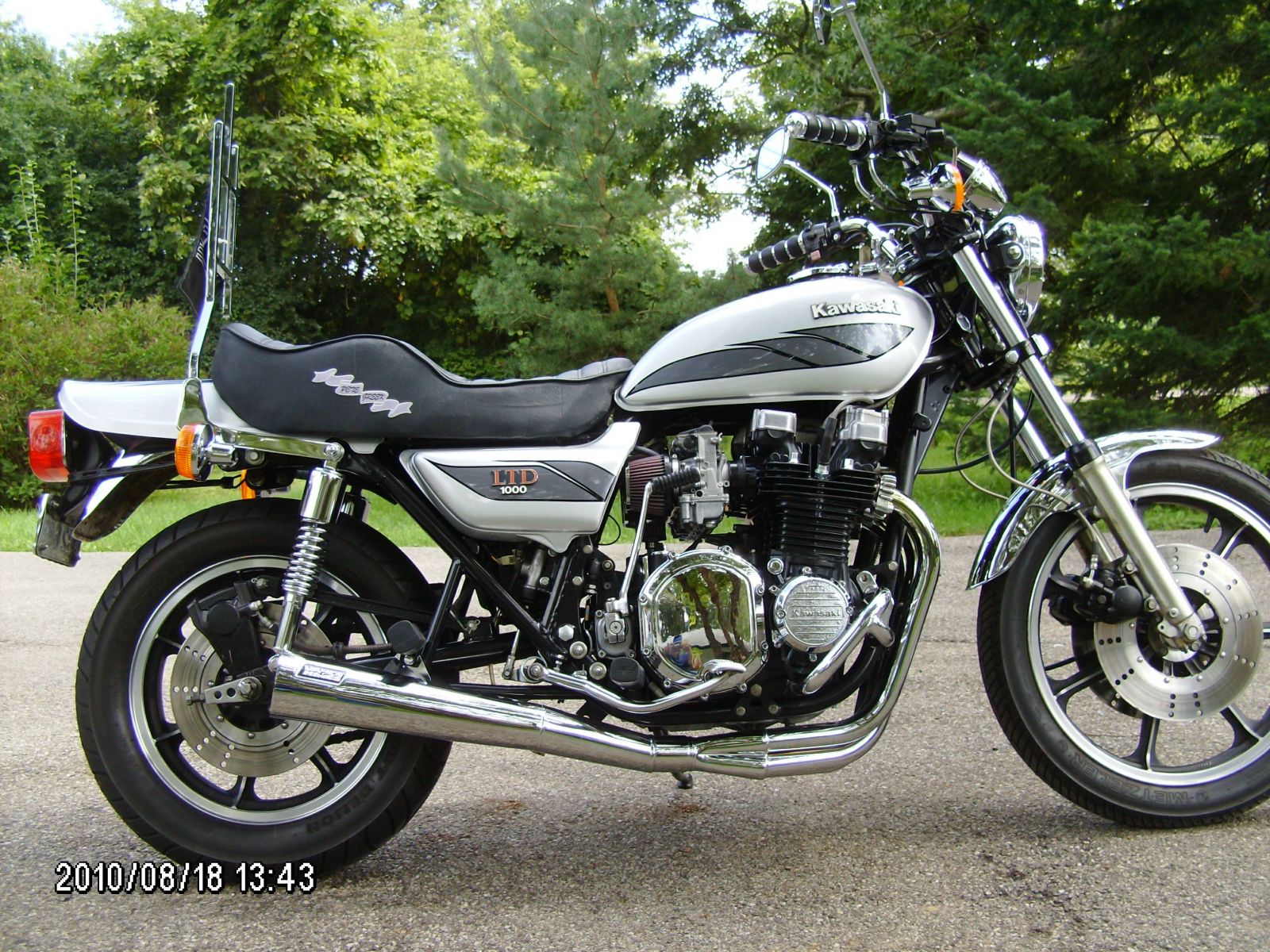

I sent out my fork bottoms to get chromed, & will be getting them back soon, & just wanted to know if there is a difference between using fork oil or sae 10 20 oil. the service manual says the 10-20 oil. is one better than the other ?? Its for a 1980 LTD 1000
