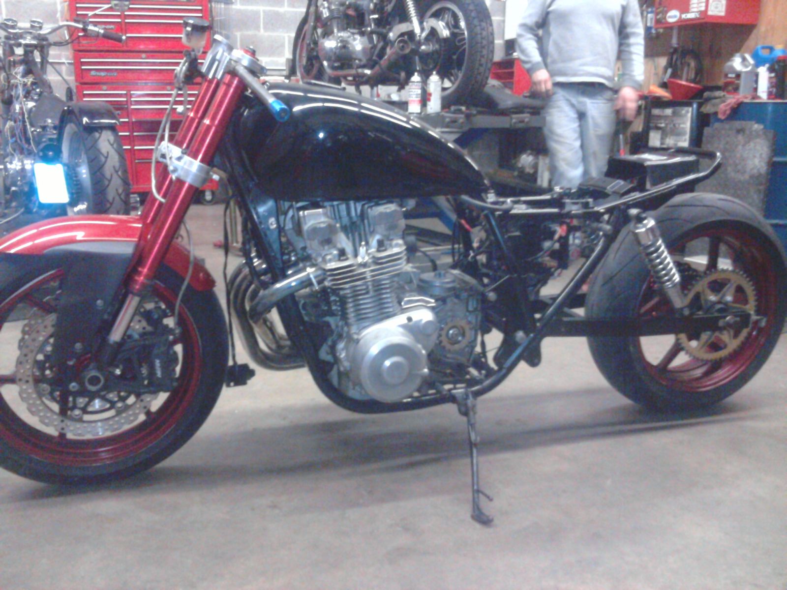

2000 Suzuki GSX750 Katana front end will go on with a simple bearing swap and filing the bottom of the boss on the top clamp. 17" tire, better brakes, same length as stock, much better forks, what more could you ask for
Want a KZ650 minus the motor that already has a GSXR1000 front and monoshock rear? My nephew has decided he needs money more than the bike.
Anyone have any pics of the sbjones bike? That's the one, and it's buried in the storage shed so I can't take pics.
EDIT:
Found a couple of pics
EDIT:

29 Apr 2011 10:27 - 29 Apr 2011 10:29wow that red and black looks slick, really diggin the front end! also what year kawi front ends? the most modern i assume would be the best setups, obviously if i wanna do a swap on my 98 honda to the newer inverted front end and bigger brakes... this one needs a face-lift

531blackbanshee , LOVE the red forks! Is an extended swingarm a must to get that rear wheel on?
