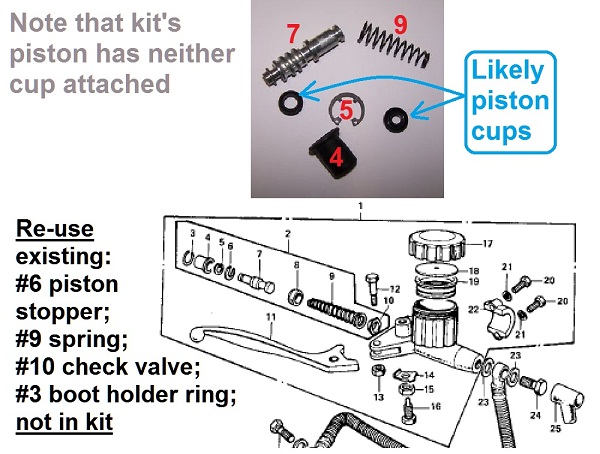

calvin17d wrote: is their any information on how to disassemble the front Master Cylinder. I cant seem to get the plunger to back out?
The piston is held inside the bore with a circlip. And the circlip must be removed before the piston will come out. The circlip is typically encrusted in position and difficult to remove, and usually destroyed during removal. Long tipped circlip pliers are needed to reach way down in there to grab onto the circlip. Kawasaki made a special tool (circlip pliers) to remove and replace the circlip.
Click > www.z1enterprises.com/detail.aspx?ID=2868
The replacement pistons for this model all come with the secondary cup (middle cup) already in place on the piston (as shown in the parts diagram on kawasaki.com), at least those I've seen.
Am therefore unsure whether you have the correct kit.
Z1E has the correct kit.
Click > www.z1enterprises.com/detail.aspx?ID=34
Click > www.z1enterprises.com/detail.aspx?ID=4269
Lots of good info on kawasaki.com, including parts diagrams, part numbers, models sharing same part, availability, etc.
Here's a link for help with navigating the site and finding information.
Click > kzrider.com/index.php?option=com_kunena&...w&catid=13&id=376734
Good Fortune! :)
