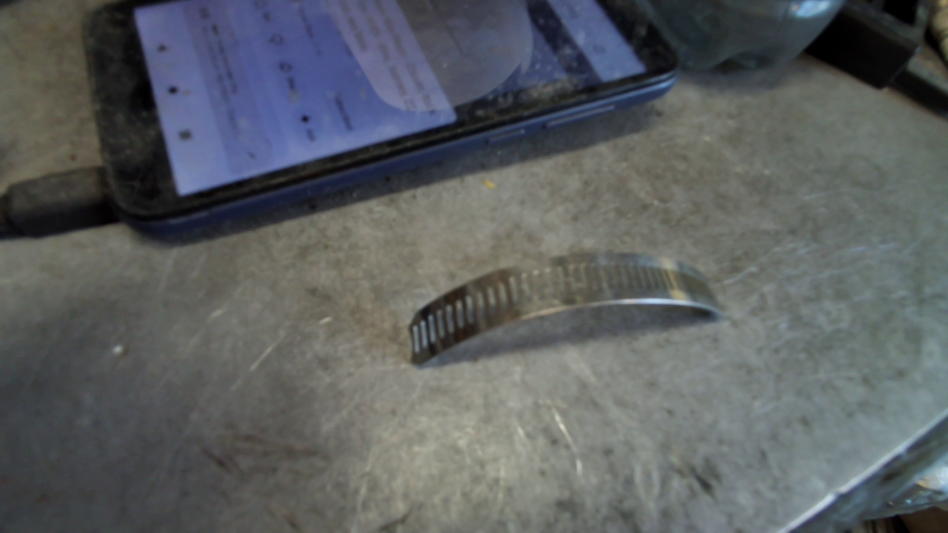

Got a 1982 KZ1000 LTD with what appears to be the original start/stop switch housing. It has the anti-rotation pin that fits into the hole in the handlebar. The location of that hole on my aftermarket bars was causing the throttle to sit about 2 cm off the end of the bar and it wouldn’t slide on all the way.
So like a bonehead I ground the pin down instead of drilling a new locating hole in the bar like I should have done. I tried a beer can shim and thin rubber shims, but it’s too loose for comfort. Wasn’t thinking this one through. The throttle now sits where it should, but the housing still feels loose and sketchy, even with shims. I def regret doing this.Has anyone successfully run one of these without the anti-rotation pin, or is that pin pretty much mandatory? Can that locating plate/pin be replaced by itself, or am I looking at replacing the entire switch assembly now? I’m trying to decide whether to fix it properly back to original with the pin or if there’s a safe way to shim it and make it work. Any advice is much appreciated and thank you in advance!
