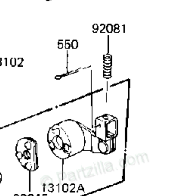

Yeah no worries, a vacuum leak has been mentioned several times and I've been trying to figure out where the problem might have been but I just wasn't seeing anything. And this is like the first time in forever that I didn't have carb cleaner or something sitting on the shelf to spray around and try to narrow down the search.
And wow... I am missing both the cotter pin and the spring! The spring does sound familiar but I don't remember ever having a cotter pin there. Where is it supposed to go? I didn't see a hole through the end of the cable, is it maybe supposed to thread around either side of the cable? I can grab another spring from the hardware store, I don't suppose you happen to have a reference for the diameter or length?

Re: Time to replace the coil packs?
27 Sep 2026 10:08

Awesome, thanks! I couldn't find any dimensional information last night on this but I figured it needed to be just large enough for that slug on the end of the cable to pass through. And nw I see how the cotter pin is supposed to works, makes a lot more sense about how it keeps the cable from falling out again. I honestly don't remember ever having a cotter pin there from the original build, I wonder if the spring tension is all that's been holding it in place all these years?

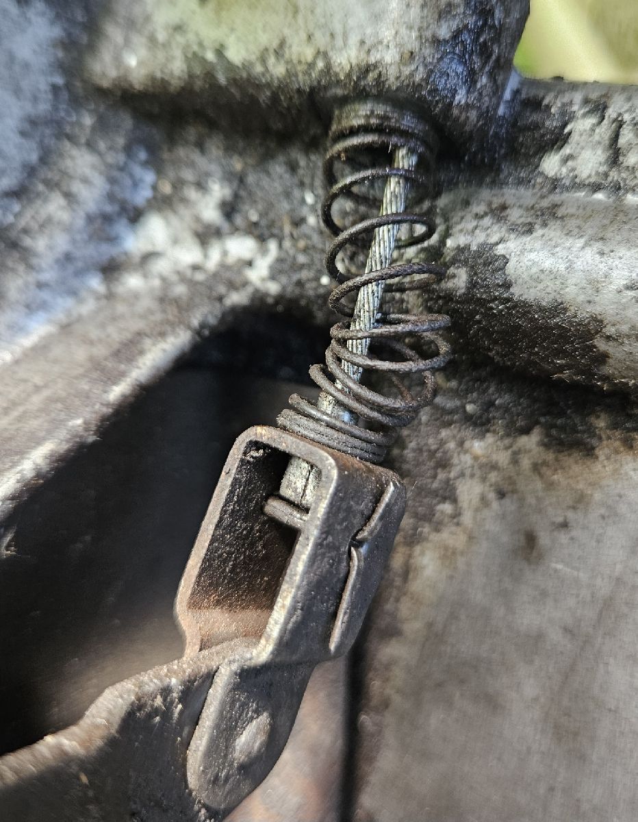

OK this seems like a worse problem now... I took the assembly apart again over lunch and found that the cable is actually still in place this time, however it looks like the plate jumped over the bearings to the next position. The photo above seems to show the position the level was in when I opened it, however I have to roll mine back clockwise for the cable length to correctly fit to the clutch lever on the handlebars, with the center adjuster a little over half way expanded. That's just where it has always been so I didn't think much of it? After re-assembling everything the clutch lever feels good again, I just don't know if that little spring will be enough to prevent it from going too far once more. Maybe I need to leave a little slack in the clutch so it doesn't pull the cable as far?

So far leaving the cable a little looser seems to be working. I've done a couple of 15-20 minute loops staying close to home and it hasn't slipped again. Feels like it fully disengages when I pull in the lever. The new carb boots don't arrive until Thursday, but if I keep it down to a 15-minute ride then it keeps running OK with only minimal popping.
