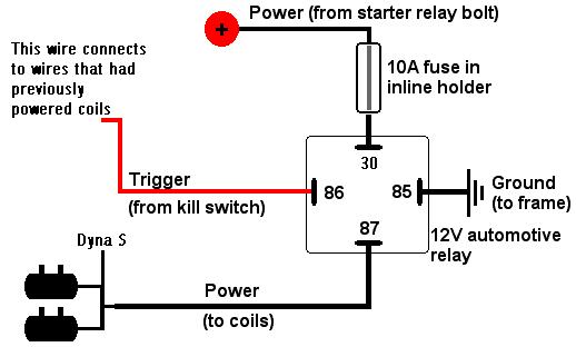

if you truly believe you have weak coils, or low voltage to the coils, test them as per fsm and fit wired george mod to facilitate full battery voltage to the coils.
