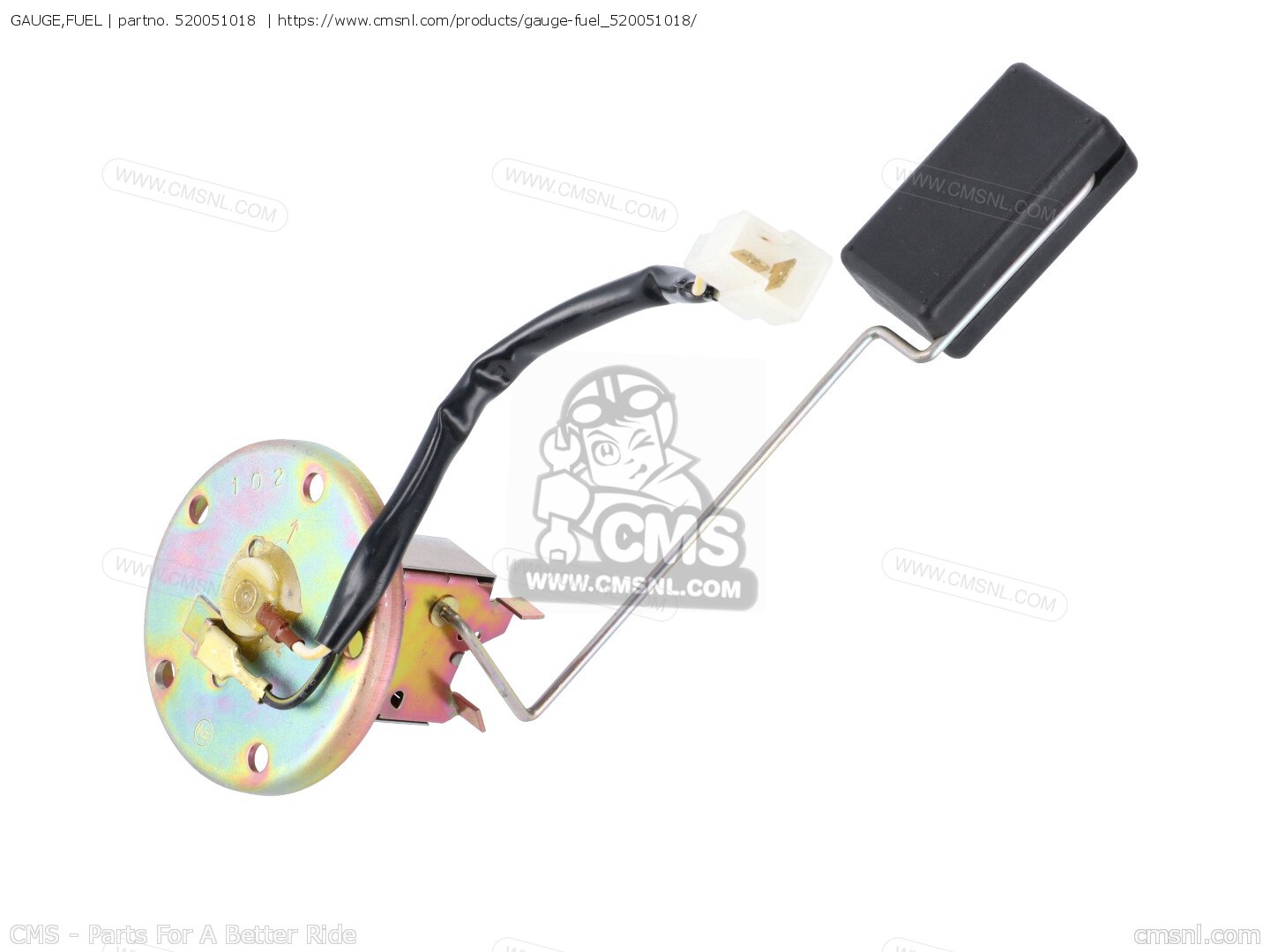

I have a couple nos KZ1000P fuel sending units in my stash of KZ-J parts...no gasket, cover, or original packaging.
See ebay item 376973607598 listing photos for reference.

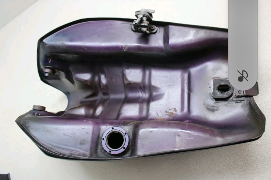

Thanks for the plug! Unfortunately the KZP sending unit won't bolt onto my kz1100a tank. Im pretty sure my tank has the circular (5?) bolt pattern.

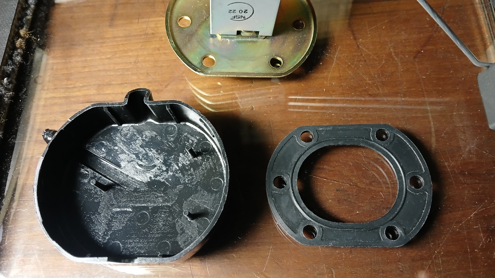

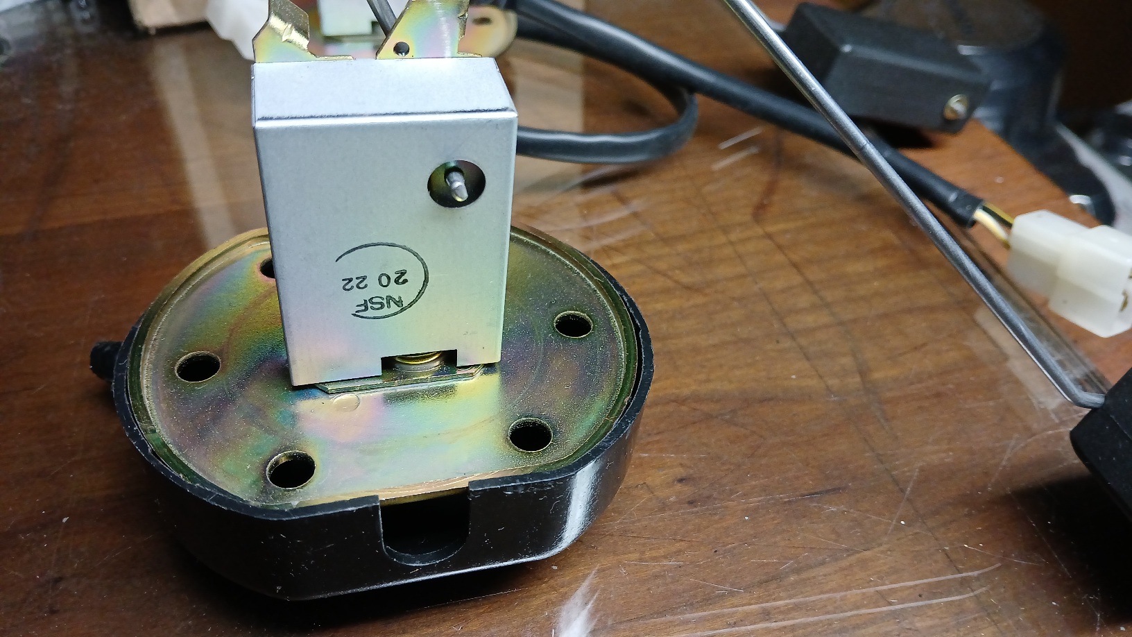

I am unfortunately aware on the rarity of these sending units, especially because the used ones are usually junk. If anyone was confused about what sending unit my tank uses, here are pictures:

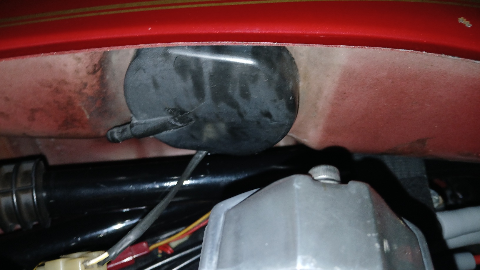

The gas tank on my 82 KZ1100A-2 has the six bolt sending unit mounting base with rectangular plastic cover.
View under tank:
KZ1000P unit:
Seems odd both (rectangular and round) mounting bases would be used on the same bike model gas tank...
