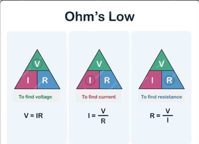

PS: where did you get a current value from to calculate 6v from 100ohms or is this a test step in the manual ?

The 100ohm resistor thing was something I found on the net and so was the 6v. Trying to remember the triangles I learnt in physics.now. Not took the ignition apart to see what's in there but as you said seems fine.
- Posts: 6774
- Thanks: 4268
Re: Non starting Zeph11
10 Feb 2026 10:21The 100ohm resistor thing was something I found on the net and so was the 6v. Trying to remember the triangles I learnt in physics.now. Not took the ignition apart to see what's in there but as you said seems fine.
